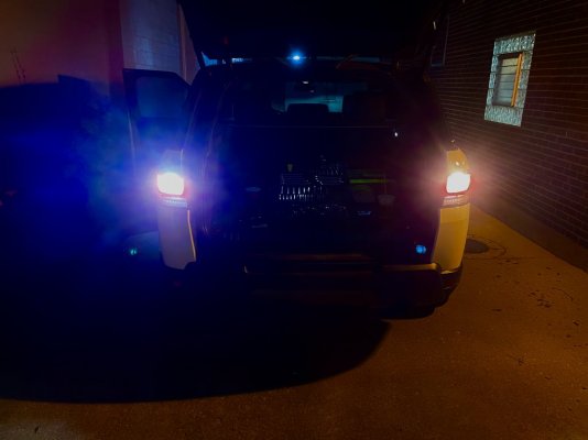

Update… it worked :)
T15/912/921 bulbs work perfect for the reverse/backup light bulb.
I called 7 different Land Rover dealers and they all said it was not possible to change that bulb and would need an entire housing if that bulb went out. ‍
