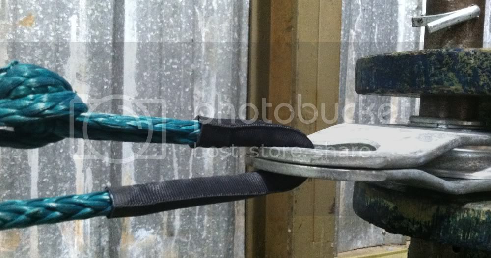

******** post 52antichrist said:It looks like in the video that the test machine's fixed point the rope is attached to meets rope fixed point attachment guidelines, about 3 times the diameter of the rope (one of the reasons thimbles are used on winch lines, to maintain a correct minimum bend radius). Most recovery points won't meet that requirement and so the load capacity of the rope will be reduced.

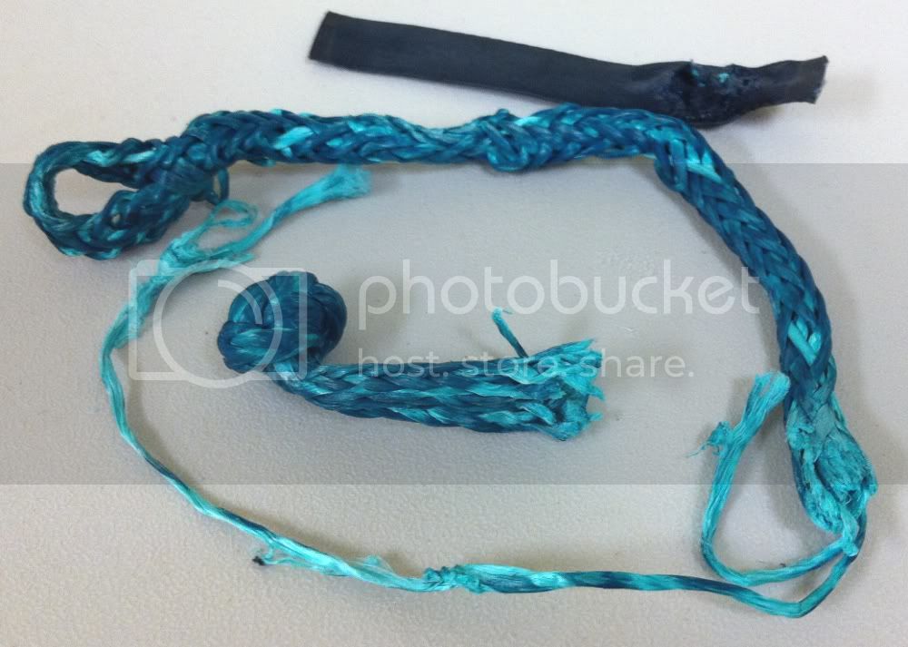

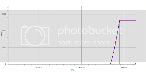

******** post 52antichrist said:Established minimum rigging guidelines specify a 3:1 safety margin (design factor) for the WLL, so breaking at 26,000lb would actually mean a WLL significantly below 18,000lb.
******** post 54antichrist said:The problem is that, based on personal observation, the majority of people off-roading don't understand safe rigging and how the load capacity would be affected by fitting one of these to a 2" pin vs. as illustrated in the OP photo.
******** post 59antichrist said:For ****'s sake, do you think you're the only person who might attach one in such a place, for whatever reason? I took you at what you later said about you not actually using it there.
I was only referencing your photo as an example of where someone might attach one in a way to significantly reduce it's capacity.

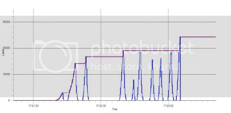

I call Bs! More so you do not know what you’re talking about. We use Dyneema® (SK75) . This is a great rope for winching and recovery because it will withstand to multiple cycling’s with out failure unlike others on the market.assuming it's only Amsteel-Blue (one of the lower rated synthetic ropes)http://www.samsonrope.com/index.cfm?rope=192
