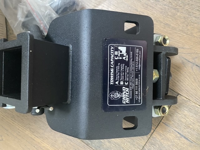

    FDCA4869-6154-49AB-A965-B8551BD61B19.jpeg Got this today. Two reasons. One is that it mounts the hitch higher so you don’t drag the quick release through the dirt or rocks when rowing at angles ( my steep driveway does not accommodate a hitch mount bike rack down low and my off-road camping trailer hitch does hit the dirt when articulated on the low hitch). Two is that there is a sizable increase in tongue weight.

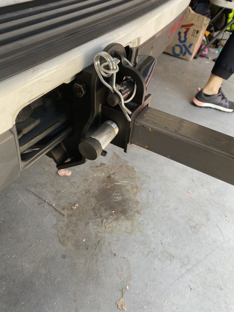

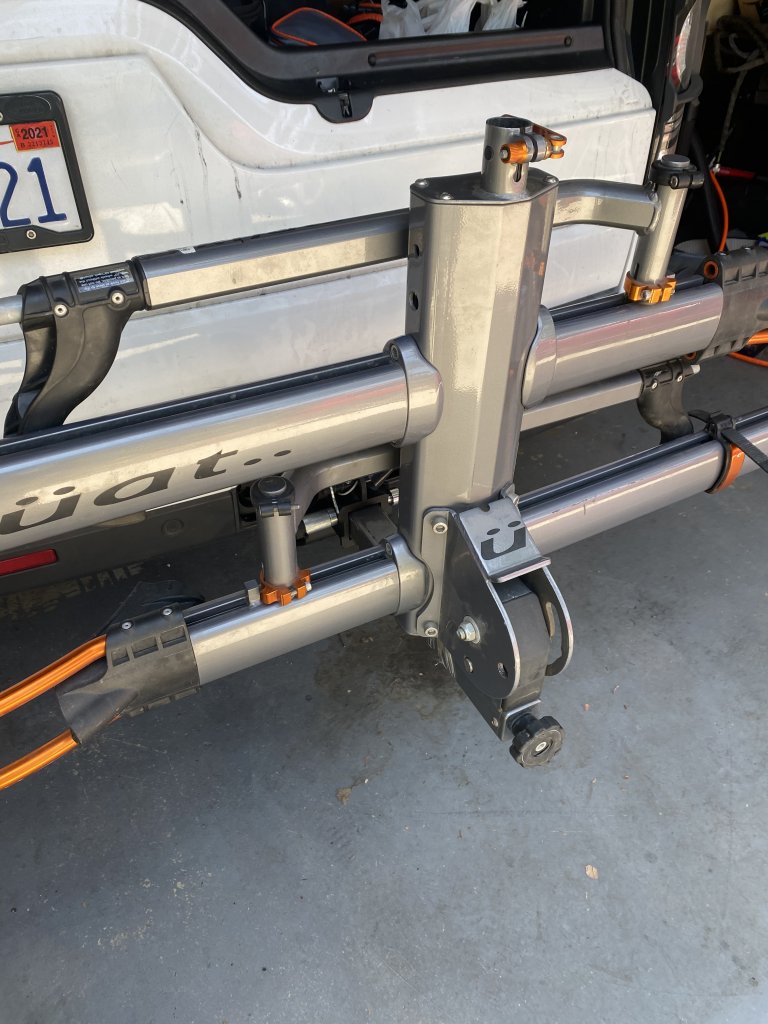

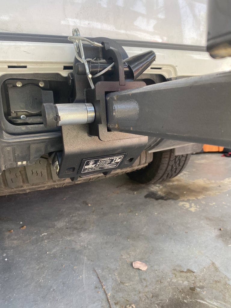

    Here are a few shots of it wit the rack on. D9552D32-9E2C-4BB7-A6CC-7E2D916D19D7.jpeg 2B91A44B-CA67-4D9D-BDAC-8E651C9E38AB.jpeg 335FC27F-7D15-4D30-B7B0-ABF0A27C1341.jpeg
    cperez and Michael Gain like this.

    Nice install. I do the same thing with the integrated pin but hadn't thought to tape it off for protection.
    That's a beefy hitch lock. My Thule uses a different security approach but I need something like this when towing a trailer.
    How did the trimming of the cover go or have you done that yet?
