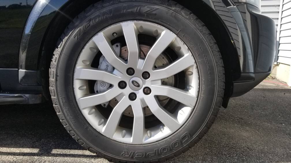

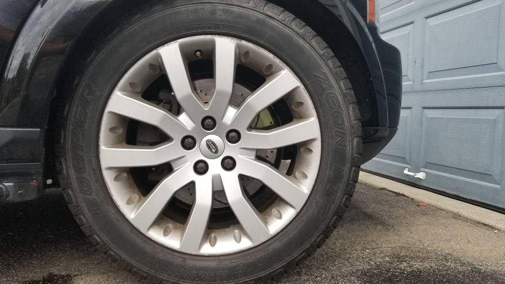

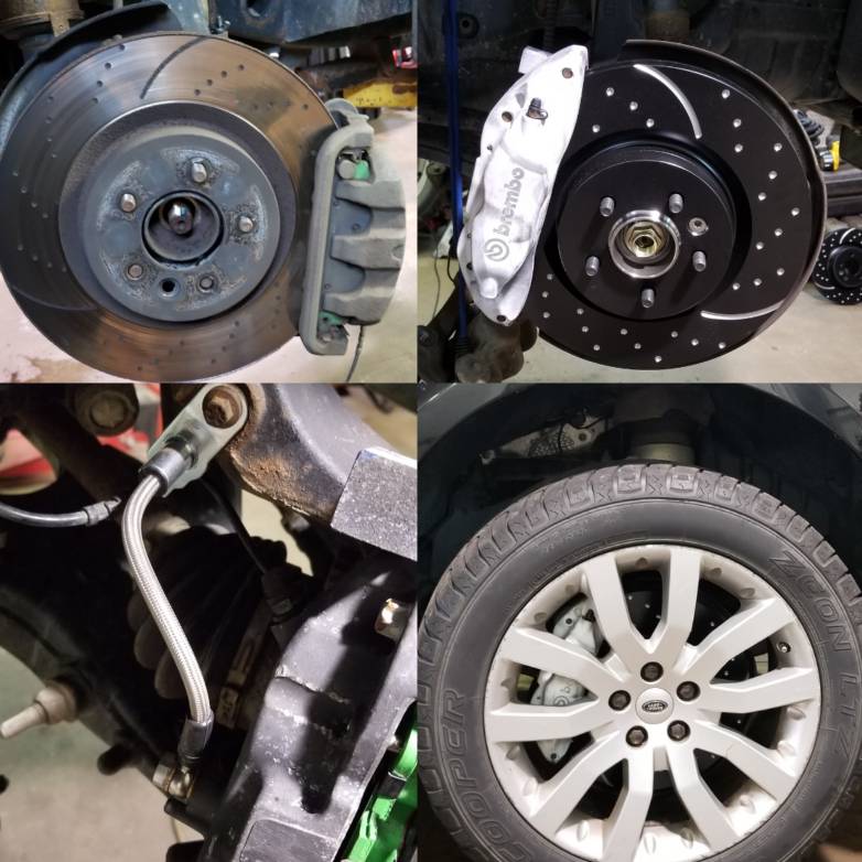

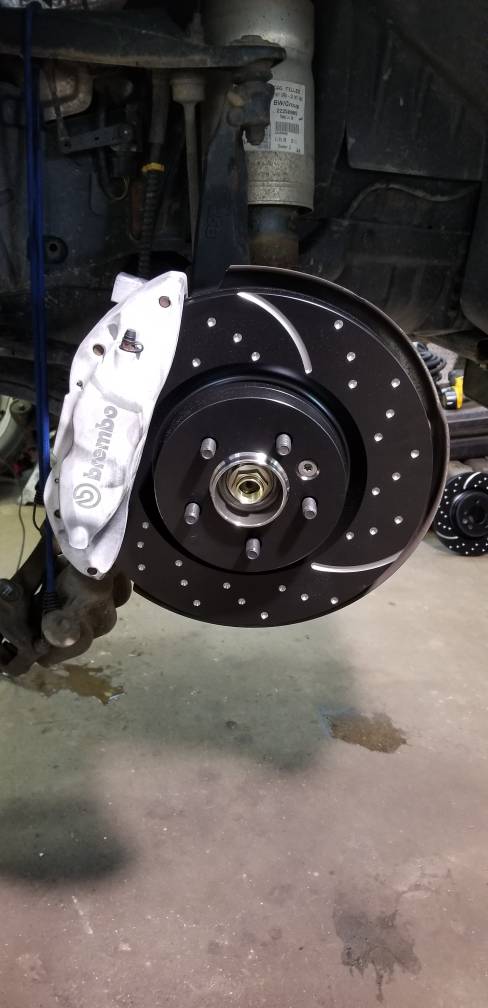

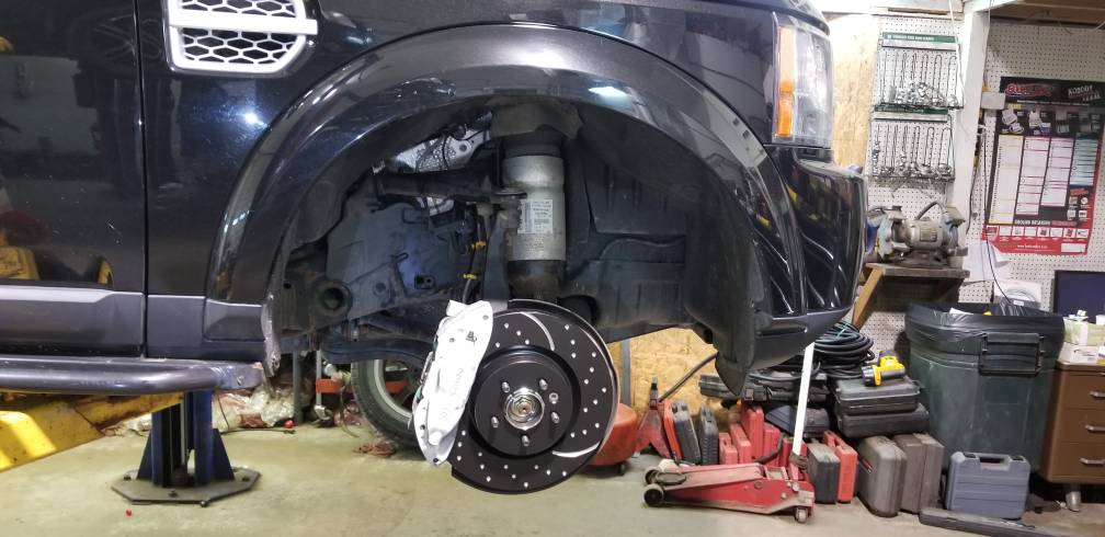

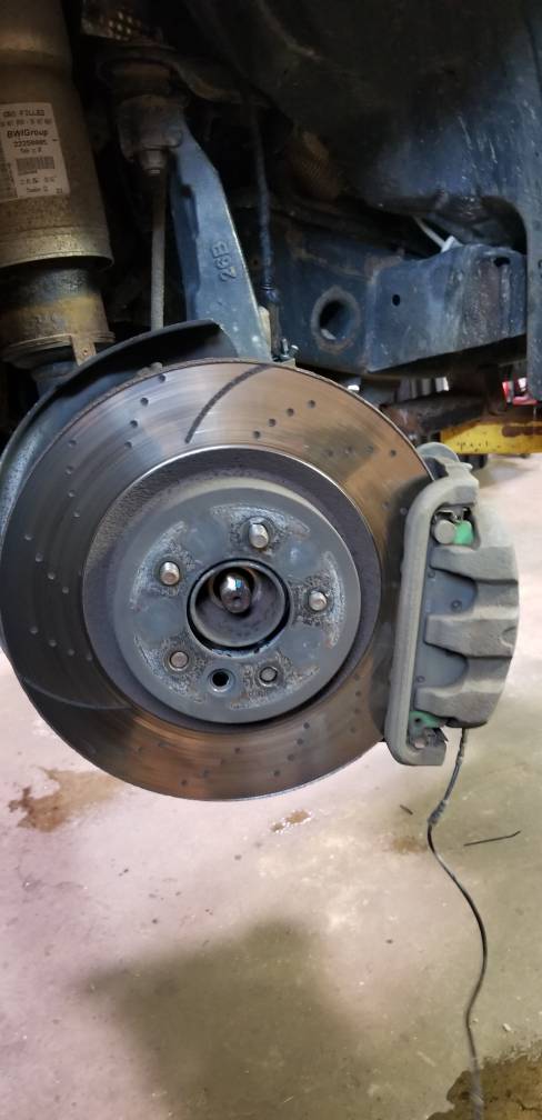

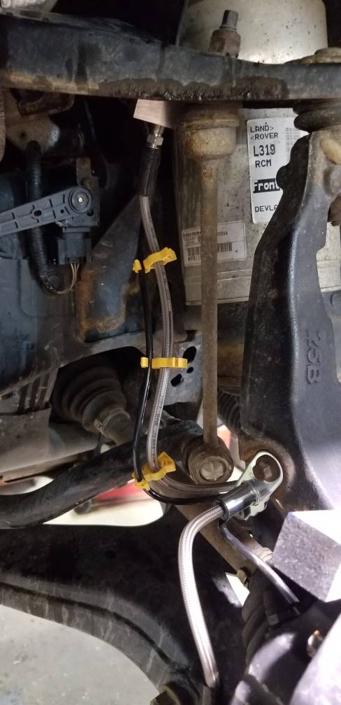

So finally got around to installing my RRS SC brake upgrade.
SS Braided Brake Hoses front and rear
BritPart kit from Lucky8
EBC Sport Rotors front and rear
Rotors are the same size between the RRS and LR4.
EBC 7000 Green Stuff Front Pads
EBC 6000 Green Stuff Rear Pads
09' RRS SC Brembo Calipers Front
While the initial assesment is very positive. I will have to wait a few 100 more miles to asses the true benifits.
However they look amazing!!!
Some before and after pictures
These are direct bolt-on. Only need to make sure you source the Brembo pads for the front, and a RRS SC Brake sensor. Everything else is the OEM LR4 fitment.
