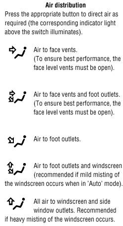

I have tried to read the code but I am having some trouble with these instructions I don't know what the (AIR DIST) is? Could you help me out with this? After I read the code I should me able to fix the problem. I would very much appreciate it your help.

Here is how you check for faults:
1 - Turn ignition off
2 - press and hold AUTO and AIR DIST
3 - while holding those buttons down switch ign ON
4 - fault code is shown in the left window, result in the right.
00 means no faults
11 in car temp sensor fault
12 ambient sensor fault
13 thermistor fault
14 heater coolant sensor fault
21 sunsensor fault
22 sun sensor fault
31 left servo motor
32 right servo motor
33 distribution servo motor
