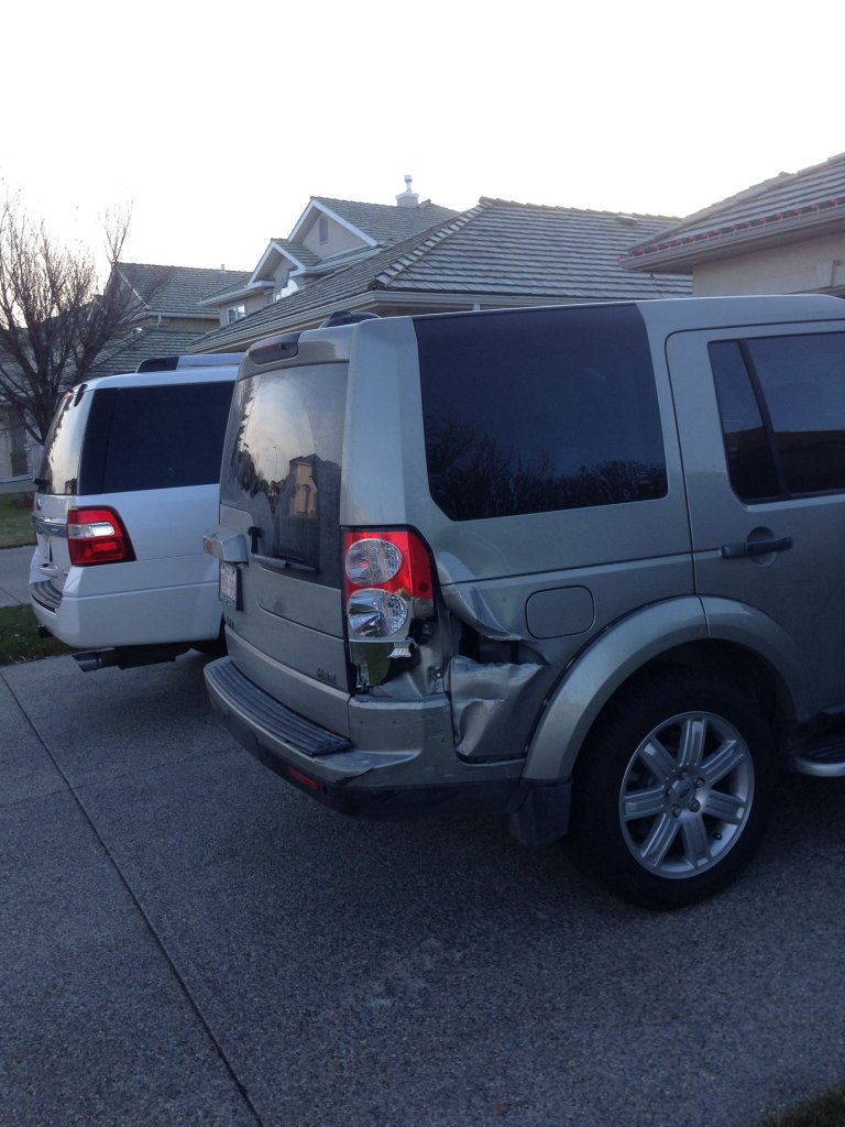

$16k worth of damage in a fender bender lol. That rear quarter panel is expensive and ships from the UK. No aftermarket body panels.
