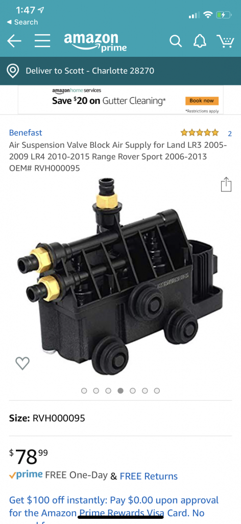

    Yes, your valve block that sits near the compressor is likely the cause. With mine, just needed new o rings. Can get a kit on amazon or eBay. Just clean the block internals and fit new o rings.

    Okay. Just bought 3 of the rebuild kits. Figure I'll start with the center one, then do the front and rear when I get time. Looks like this is an eventual problem on a lot of EAS Rovers, so I won't feel too bad if this doesn't fix my issue as it's apparently something I'll need to do sometime anyway.
    I can't find any info on the location of the center one, though. I assume I'll be able to find it easily once I crawl underneath. I'm guessing it comes after the air tank in the system, correct?

    you only need one kit. The center kit in the photo is what you need.
    the valve block sits right in front of the compressor. I used my gap tool to deflate the system down to bump stops (definitely want to do this).
    this is what the block looks like

    So one kit does all 3 valve blocks? Guess so, looking at that photo and having watched a few videos online.

    Yes sir! The center o rings are the ones you’ll need
