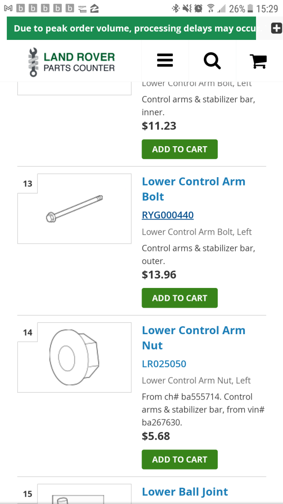

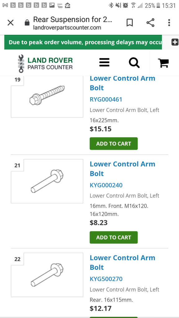

Im struggling to figure our why the front and rear nuts would be different. and unfortunately the description (both in your picture and a google search) don't indicate LR025050 to be for the strut mounting. Actually, i have found LR025050 to be used for ball joint bolts. https://parts.landroverriverside.com/oem-parts/land-rover-lower-control-arm-nut-lr025050

rear bolts (2) RYG000461 (M16x225mm)
front bolts (2) RYG000440 (M15x200mm)

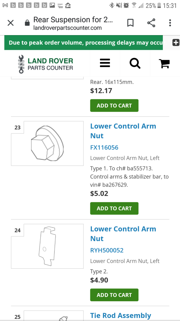

nuts (4) FX116056 (M16)
for about $80 worth of hardware, id really like to know its correct before ordering.

You're right. Reviewing the OEM part numbers on the Atlantic British kits, they both use FX116056.
You can always call a parts counter to confirm, but I think that you're good, my friend.
