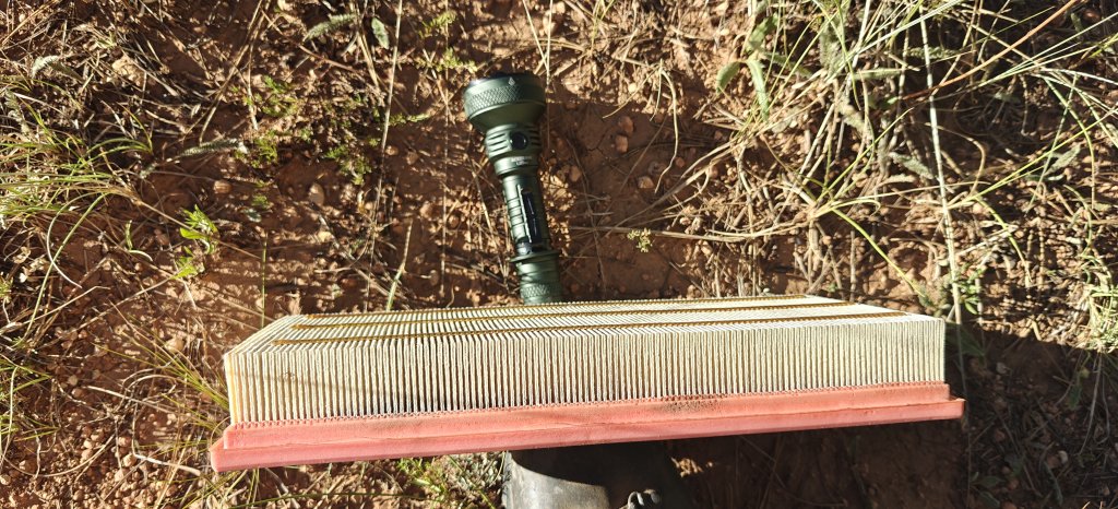

I checked the Wix air filters and took a pic of it along with a shot of the amazing flashlight (Acebeam L35), it works well to see any animals stalking me at night as well as inspecting the engine, like cracks on the serpentine belts for example. I'd guess the oil is clean enough for now based on the air filter

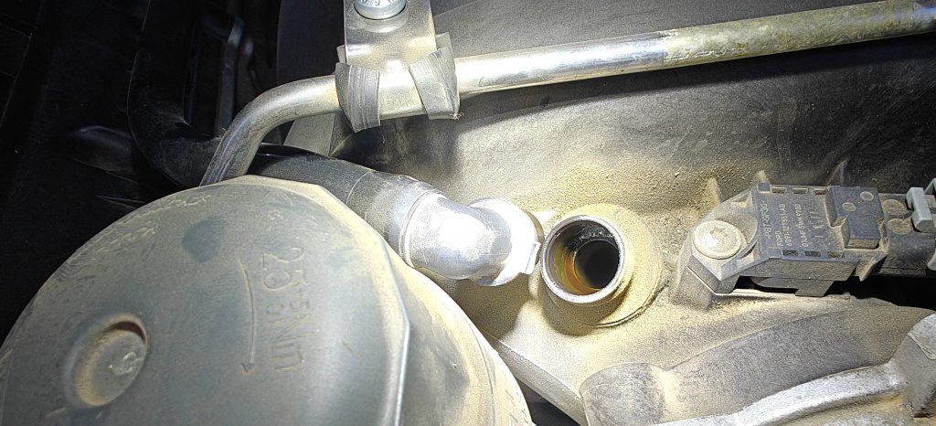

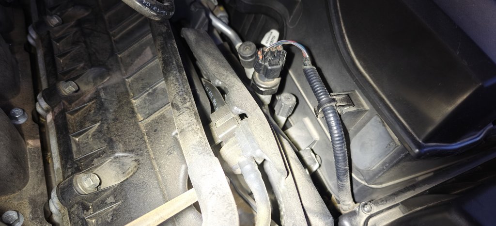

The PCV valves are original, ~108k mi now. Replacing them luckily looks straight forward, but I've never dealt with the PCV valve before on any engine. There is oil/dirt residue that wasn't around the port previously at 101k mi. The oil/dirt around the oil filter housing wasn't present either, but back then the truck hadn't been in the dirt before I bought it. Should there be oil going into the intake?

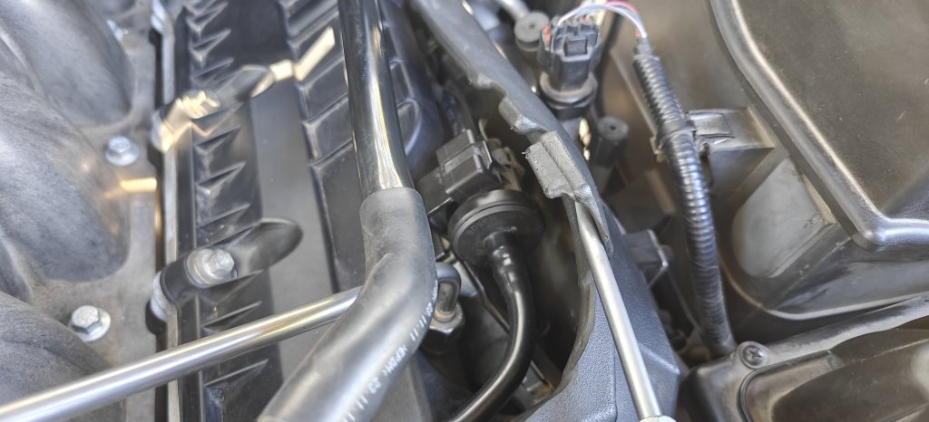

on the driver side there is a diaphragm looking thing that looks like it has oil + dirt that wasn't there before, but it had not been subjected to so much dust

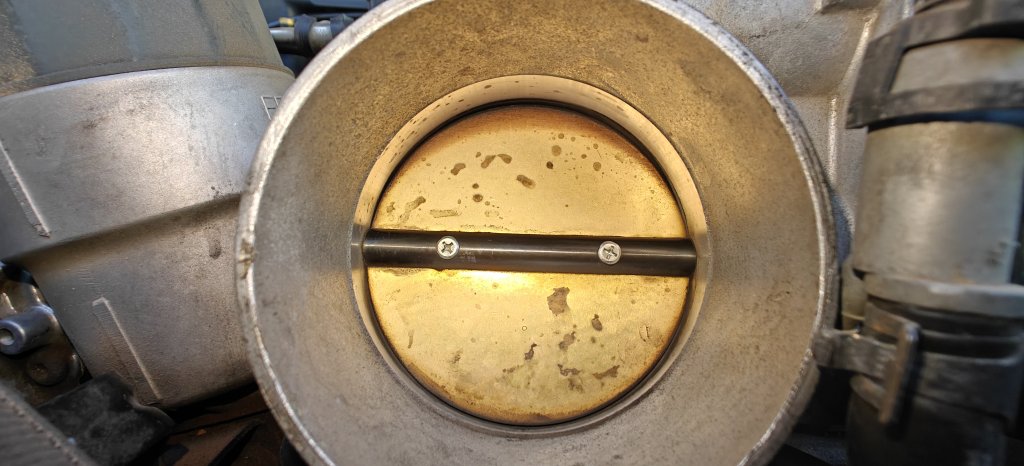

Pop the intake off and look at the throttle body.
Looks slightly dirty but it has the same look as when I had the intake off at 101k mi. The water spots (whatever they may be) don't wipe off.
