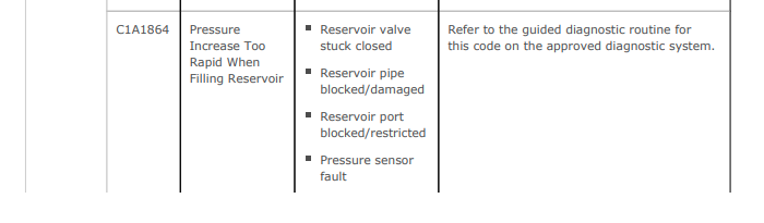

This thread is in French, but this post attaches a handy troubleshooting guide for the RRS that's probably applicable to the LR4s as well.
https://forum.club4x4.ro/showthread...ion-required&p=1098972&viewfull=1#post1098972
EDIT: I was able to upload the troubleshoot PDF here. This document looks to be an amazing resource.
As far as my code is concerned, the pdf states this:

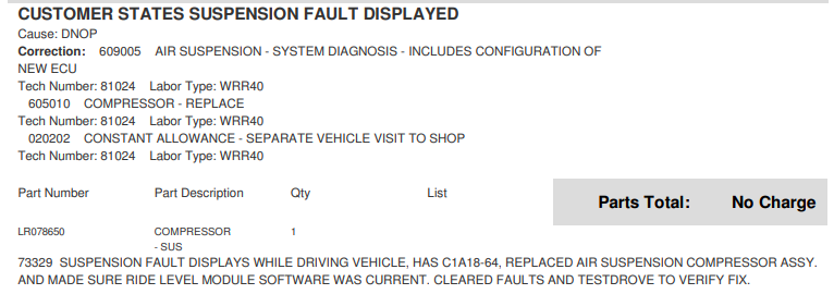

Dealer called late this afternoon and said it's ready to pick up. I had to go out of town, though, so I haven't picked it up yet.
Looks like they replaced the compressor. My LR4 is a 2012. I believe I had the AMK compressor, but I'm not certain. They replaced it with an AMK, though.
Glad this was under warranty. According to the guide I posted earlier in this thread, I would have been messing with the reservoir and valves and not the compressor.

Picked it up this morning and everything works great. Service guy told me that the compressor was weak and not pumping as much air as it should. Wonder if the "pressure increase too rapid" interpretation of my code is actually just a sensor that notices a deviation in the speed by which the reservoir fills, meaning that the pressure increasing too slowly could set it off too?
