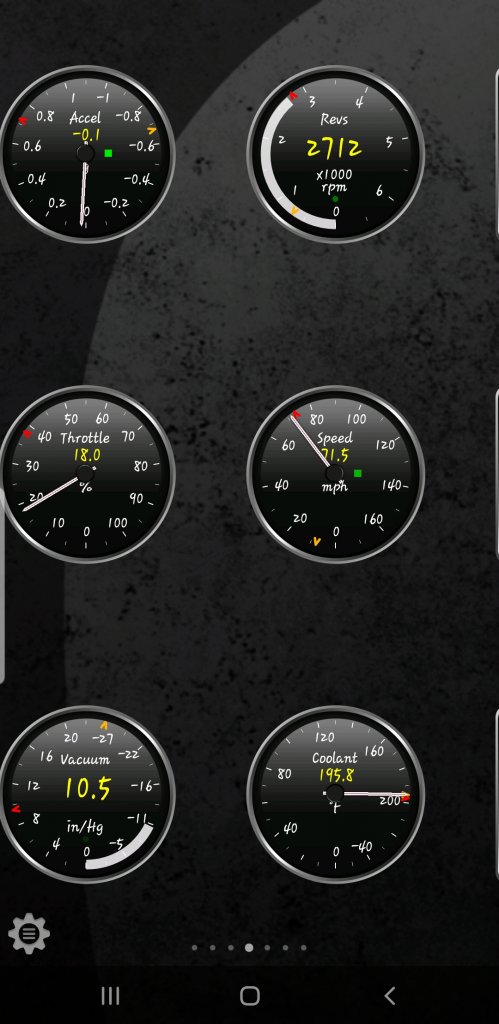

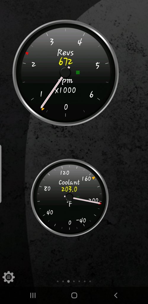

I've had my Disco II for almost 10 years now. I've put 75,000 miles on it. Now at 180,000+-. During all that time the engine always felt hot no matter what I did. New thermostat, fresh fluids etc.etc. I finally got around to having a full system flush done by a radiator shop. They put in the orange DEX and distilled water. I added Water Wetter and swapped the stock thermostat out for a 180 degree thermostat. My running temps at 35mph have dropped from avg 212 in motion to as high as 220 at stop light. They are now 195-199 running at city or highway speed and 203 at stop light idle. See pics of screen shots I took from the Torque app and OBDII reader on my Disco. Note speeds, rpm's and temp. Now when I pull into the garage it doesn't turn it into a furnace and you can touch the hood without calling out "Damn that's hot!" Truck now runs much smoother and with a little more pep.
I am very happy this worked for me. It might work for ya'll too.

A smart move installing a 180 stat vs the higher factory stat. BTW it's a Federal and a No No to install a lower temp stat, a EPA enviromental or **** regulation thing.
Best part there is no increase or difference in tailpipe emissions readings.
The thing you must check first before installing any stat is to check it's opening temp in a pan of cold water slowly heating it as their opening temps are all over the place in temps. Tested new stats having just starting to open at 5-6*F temp variations even with a so called 180* stat. Fully open into the 195* to 197* temp zone.
