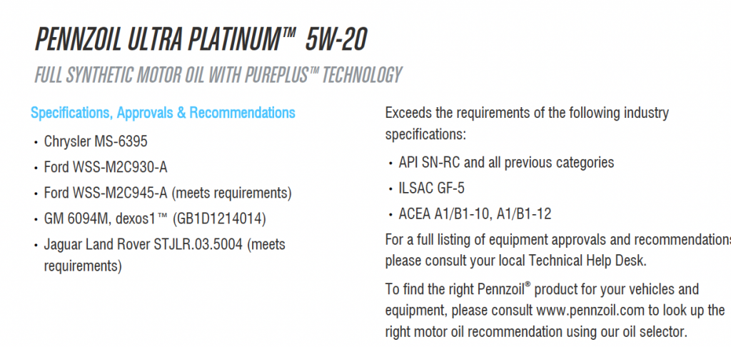

Pennzoil ultra platinum meets it.

Thanks everyone, didn't mean to whack the hornets nest....
Here is a bit more for those (like me) hung up on the specification...
I did find on a Blauparts page that the STJLR.03.5003 specification "will always correspond to an ACEA A5/B5 specification" "Also, the original STJLR.03.5003 specification may have referenced the ACEA A1/B1 specification. This is now obsolete and has been updated and replaced by ACEA A5/B5."
https://www.blauparts.com/blog/land-rover-engine-oil-types.html
The Ravenol site has a good discussion of the ACEA specification itself.
https://www.ravenolamerica.com/standards-specifications-and-classifications-of-lubricants/
On my bottle of Castrol Professional OE, (purchased Spring 2021 from AB), I do not in fact find the JLR specification but I do find ACEA A1/B1.
I did a quick look see and I find that the ACEA A1/B1 or A5/B5 specification is indeed available but one needs to check the individual brand, type, and viscosity because it's not universal:
