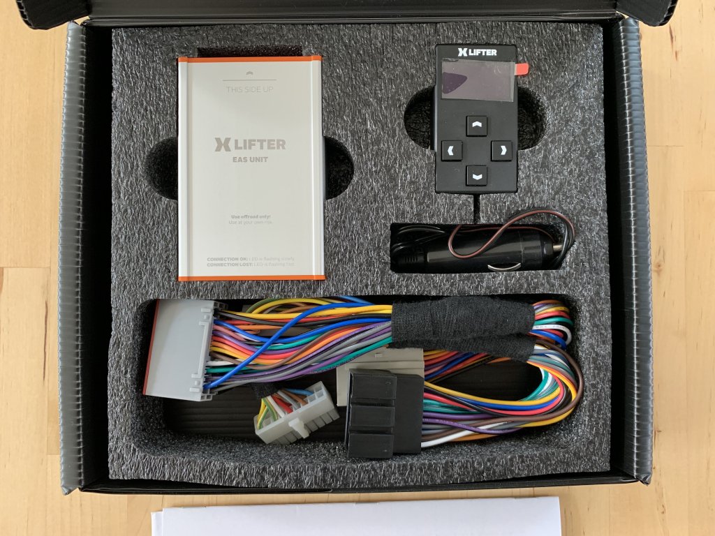

The installation is reasonably straightforward. There are two main parts: the brain and the controller. Because the brain contains accelerometers used for the auto-levelling function, it’s orientation of install is important and they recommend attaching it to the factory EAS computer (it comes with 3M Velcro strips already on the base).
Gaining access to the factory EAS computer is pretty easy - there are a couple of screws that hold the panel in place above the pedal box. I found it a bit of a wrestle to get the panel out. The EAS computer is located up high, towards the base of the A pillar. On my 2015 LR4, I found another computer located beneath it that continually got in the way. It didn’t seem easily removable, but by undoing the two lower retaining nuts, it was able to be pushed out of the way to get the job done.

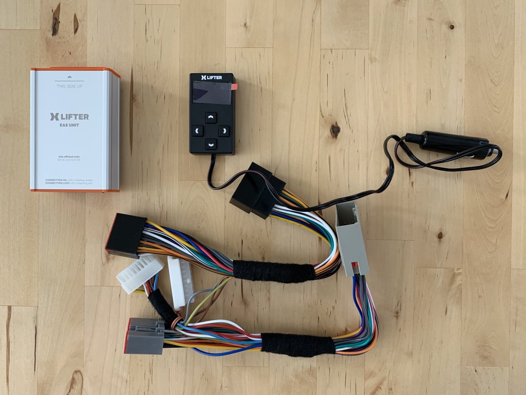

The XLifter brain is about half the size of the EAS computer and I found there was just enough room to squeeze it up beside their factory computer and get your hand in there to press it together. The kit comes with a loom that uses OEM connectors and it’s really simple to disconnect the two plugs from the EAS, plug them into the loom and then plug the loom back into the EAS. When all of that’s in place, the loom can be connected to the brain. There’s an LED on the base of the XLifter brain that tells you if it’s working.

Out of the box, the controller comes with short lead that has a cigarette lighter plug on the end of it. The controller connects wirelessly to the brain and only uses the wire for power. As soon as I plugged it in to power it connected to the brain immediately and I was able to control the device.

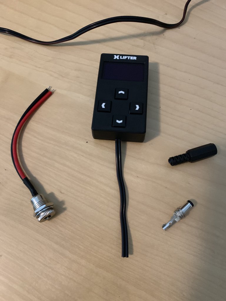

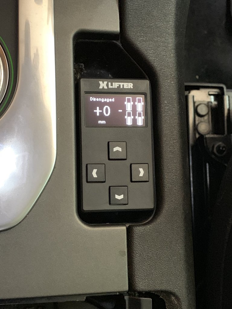

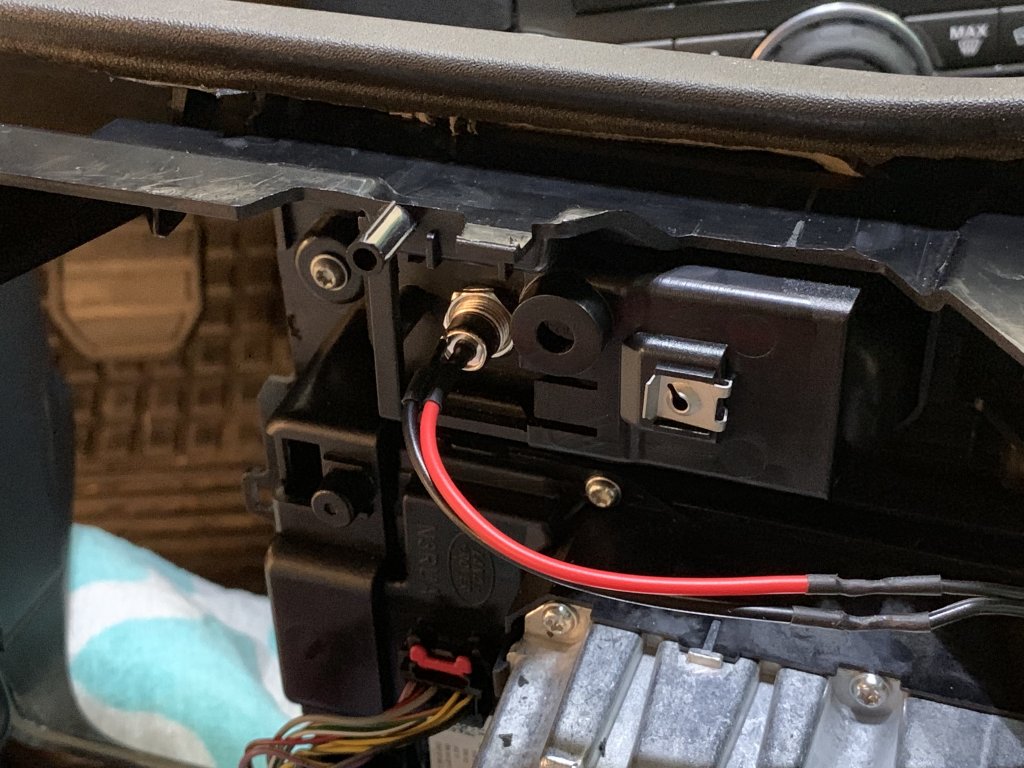

I’m a sucker for OEM-style installs, so I decided to take things a step further. The controller happens to fit perfectly in the little coin pocket opposite the e-handbrake on the LR4, so I decided to mount it there. I also considered mounting it next to the vehicle’s suspension controls but didn’t want to drill a hole in that panel.
Gaining access to the centre console is ridiculously easy. After pulling out the cup holders there are two screws and then the whole thing just pulls out. I bought some simple barrel-style 2 pin connectors off Amazon and drilled a hole in the bottom of the coin holder to mount the socket. I patched into the factory cigarette lighter socket for power and cut the fly lead of the XLifter controller to about 2 inches and attached the plug onto it. The unit stays perfectly in place but if I needed to, I can remove it in seconds.

Using the XLifter is straightforward: pressing up or down on the remote control selects a height and a second later it begins to apply the change. The left-hand part of the screen shows the current offset in mm and the right-hand has a graphic representation of the current suspension set-point and the current suspension position - very similar to the 4x4 screen on the infotainment system.
Hitting the right button opens up the device menu, where you can access the autolevelling function. This can level the car up to +/- 4 degrees in both axes and the screen shows two spirit levels representing the car’s current balance. Levelling takes about two minutes: in the first minute, the car goes through coarse levelling and the second is used to fine tune the position. The system remembers the last selection, so when I level it at camp and start the LR4 up again in the morning, it gives the option to exit autolevelling and return to normal.
