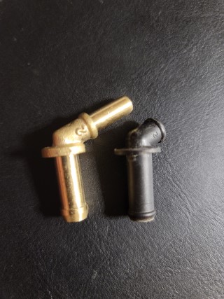

I found this little gem after having to do a water pump replacement on a new to me 2017 D5 Lux with the SCV6 that I purchased the first of Dec. I was in a bit of a rush to get into a vehicle since my LR4 was just in a hit and run with a underage driver (and my D2 had just sold the week before). I am still waiting to see if that will be a total write off. Anyways bringing the D5 home the water pump started failing so I went and did a replacement. Putting it back together again this little pipe broke and I started looking for a replacement when I found this. Hopefully it can help someone here with a LR4 that might find themselves with the same issue. Beats replacing the entire hose if is it not needed plus it is made out of brass.
