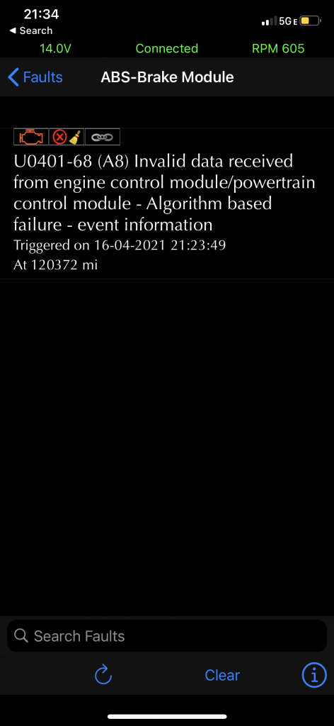

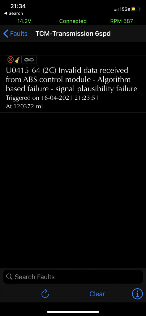

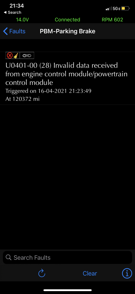

Well had a subwoofer put in and got the car back early this afternoon and everything was great, until I got on the freeway. After going over 45 mph the every light on the dash came on (stability control, ABS, parking brake, cruise control, suspension, transmission etc.) I’m not too familiar with electronics on these cars but I do know that any thing below 14V will cause the electronics go insane. Any ideas on what I should do? Here are the codes.

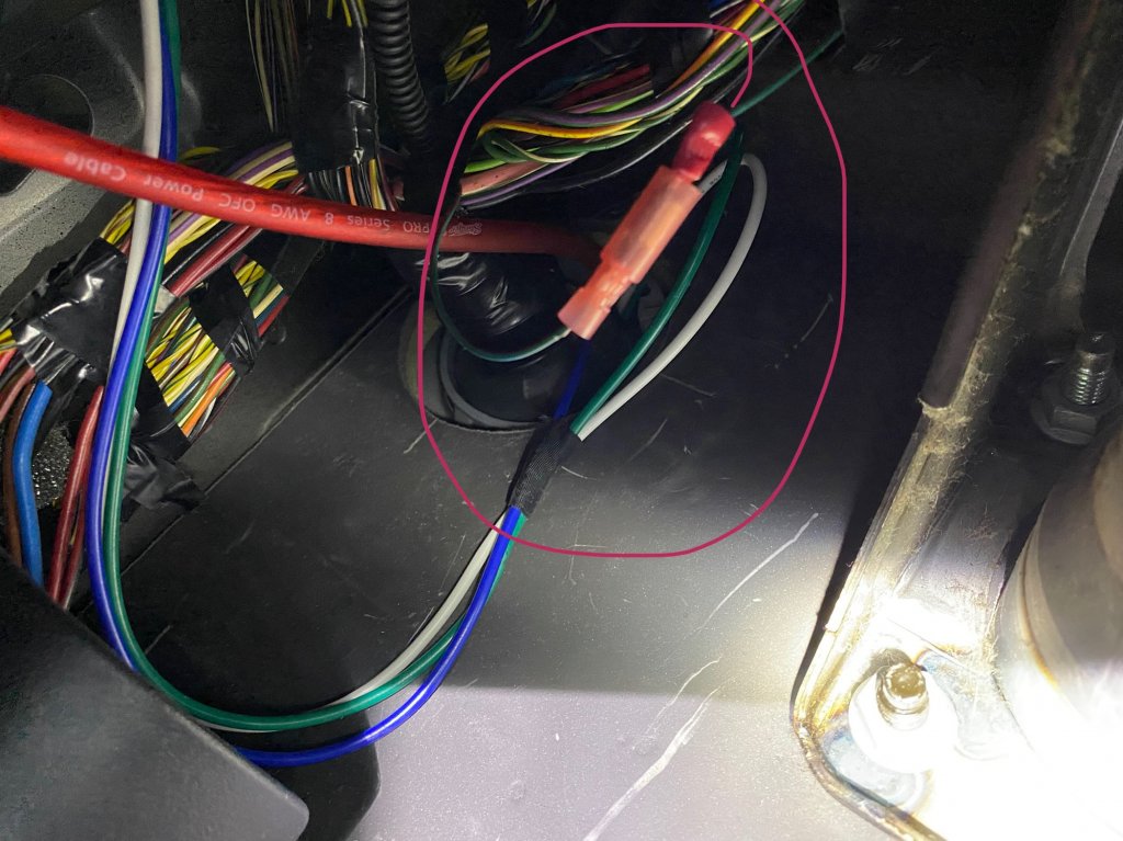

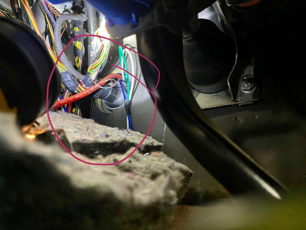

Hmmm. It depends on the install. I would explore every place they could have touched. If they installed the sub in the rear hatch, I would pull the panel and check out the other harnesses. If they pulled the center console (I'm sure they did), I would check the EPB switch and all the random modules underneath the shifter / cup holder. If they ran the wire along the driver side scuff plate and under the drivers knee panel, I would pull that panel and inspect the gateway module and other harnesses under there.
They also were under the hood to hook up 12v power. I would trace whatever lead they installed and make sure they didn't knock anything loose / forget to reconnect something. Depending on which side battery box they used to feed the positive wire into the passenger compartment, there a host of issues they could create.
Could be an honest mistake by the shop. Likewise, it could be a huge coincidence and unrelated.

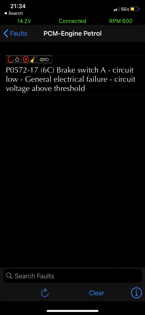

Is the brake switch still throwing a “P” code? That seems to be the only “P” code listed, so that might be a place to start. Maybe the brake switch is shorted so that its always “on”?
