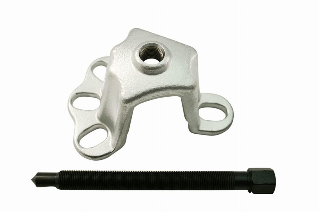

Hello,
Anyone have a link to a tool that they know fits the hub lug pattern for pushing in the half shaft axles? I'm trying to remove a rear half shaft to fix a torn CV boot but the axle is not moving (lots of pounding with sledge with block of hard wood and it wont move). I'm looking for something like:
but all I find are too small for the 5x120mm bolt pattern.
Thanks.

I've never had a problem getting them out. I used a punch and hammer. If you're willing to pull the brake disc, you should be able to use a 2 or 3 arm puller that instead of one that goes on the wheel studs.

Thanks. Yes ended up using a 3 jaw puller. Had to crank it down as tight as I could then hammer on it. Shaft was really seized to the hub. Other side basically fell out. New bearings, backing plates, upper/lower arms, track rod, brakes...
