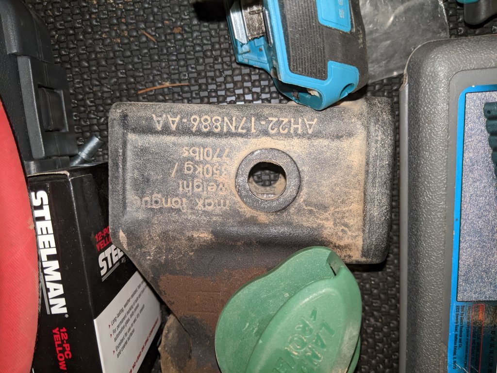

My receiver attachment has printed in the cast iron 770lb tongue weight, which is 10% of the tow rating:
I wouldn't worry about the self leveling suspension, if anything it will prevent the rear tires from wearing funny. It won't adjust the ride height higher than intended, just back to "normal". As long as you don't also max out the cargo capacity, there should be no issues.

Thanks ftillier, that's actually reassuring. I can't imagine a scenario where they would have a 7,700 lbs. towing capacity and 770 lbs. (10%) rated receiver and not have that be the intended max tongue weight. It would be so misleading as to invite overloading the tongue. I can't imagine Land Rover's lawyers signing off on stamping the factory receiver at 770 lbs. if the max capacity was 550 lbs.

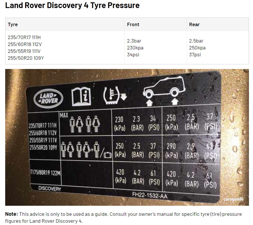

You have just discovered the issue with many SUVs (and modern 4 door trucks) who tow and carry passengers. There is a balance of everything. A LR4 cannot tow it's max rating and carry a full load of passengers, at least not legally.
You will also notice that the tire inflation pressures are listed as 36 front, 42 rear. Seems like an odd combo but here in North America that 42 assumes you are running full load. In other places you may see a second set of numbers like 36 front, 37 rear (half load). But ever since the Firestone debacle the lawyers must have gotten rid of that.
Here is what a tire placard looks like in parts of the world where lawyers don't rule the roost:
