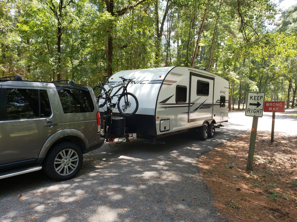

I use a tekonsha p3 brake controller with the ford wiring adapter. Install was very easy for the controller as it was basically just plug and play. My new RV is 4200lbs with a 390lbs tongue weight. I kept with the rule with keeping it under 80% of the towing ability and that being said i am happy with the way the 4 has been towing. I am seeing around 13.8 mpg and power to handle the hills and passing. I am also using the anderson WD hitch and the camper has been steady in winds. The only problem I ran into was having to install resistors on the trailer wiring so that the 4 would pick up it was connected due to the LED trailer lights. I found a great writeup on this issue here on the site. 2011 LR4
