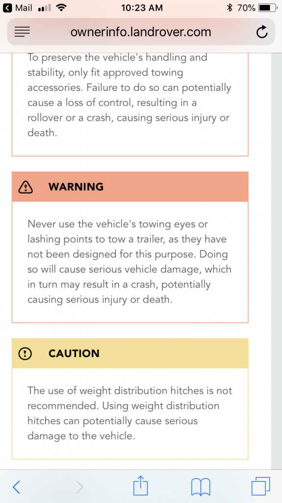

    This is enough information for me. JLR has done a lot more research on the subject than myself.
    http://www.ownerinfo.landrover.com/document/3D/2017/T22693/22188_en_GBR/proc/G1858166
    The rule of thumb only really applies to a vehicle with traditional suspension. Talking with experts who have no major experience with 4 corner air suspension does not add any significant data IMO. I have talked with a few different RV places and they all recommend WD at a minimum. When I ask them why JLR states something to the contrary, they cannot muster a reasonable response (at most I get a lesson on how WD works). This is telling in itself. Also who benefits the most from you using a WD system, when the OEM suggest otherwise? The person selling it to you. I have scoured the internet, and the only people who adamantly push WD or sway control, for ALL vehicle, are dealers and trailer manufacturers.

    Ah, so this is interesting. Note this is the fourth note in this section. The first three are “red alert” warnings with the languagr of “never”. The WD comment is a caution and recommendation.
    To me this is “use at your own risk” and the risk is a blown suspension that warranty won’t cover. From a liability standpoint it’s super grey area. On one hand defense counsel will say it might just break electronics of suspension and plaintiffs counsel will argue that it inherently means a dangerous situation was caused. Is it negligence? Maybe? Gross negligence? Probably not. Is there any case law? None I’ve seen - but I haven’t done an exhaustive search.
    Like all of the vehicles I’ve modified in my time while under warranty I think this falls in that bucket - if properly set up and thought through risk is minimized. Does it go away? No. Can you make it deminimus? I think so.
    Possibly one of the most interesting topics you read on the web with honestly no definitive answer. “Caution” and “not recommended” is not finite. Skewed. Sure. But not “never use WD”.
