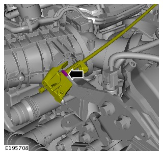

The P1707-77 DTC could be caused by the manual park release cable sticking.
Look under the hood, on the left side. You will see a short lever that is used to the park pawl.
Cycle the lever a couple time and make sure it is released back to the down position.
This can also trigger the other DTC.
We checked the cable and the manual shift lever itself. Unfortunately, the transmission continues to display fault codes.
