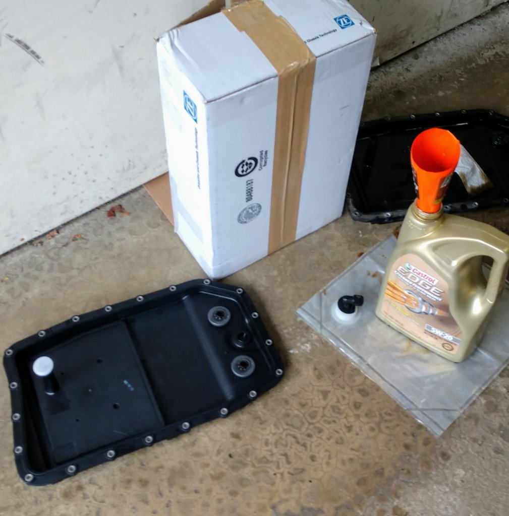

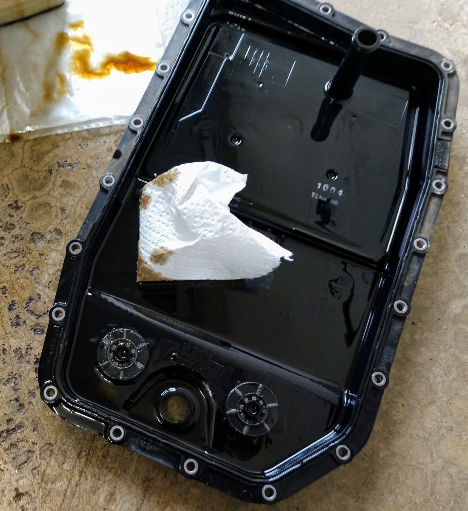

georgekale
Jul 14, 2015
37
15
Right way is factory way. Replace the pan with a new factory pan and ZF fluid. Flush is OK.
Notice the magnet holding steel filings, you won't get this out with a flush. pan is also the filter.
