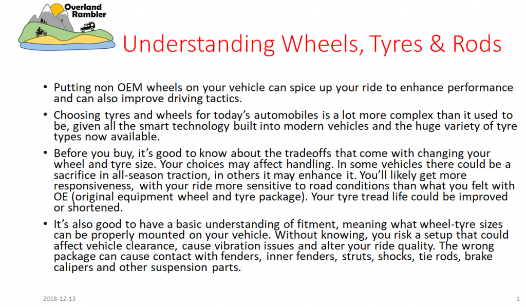

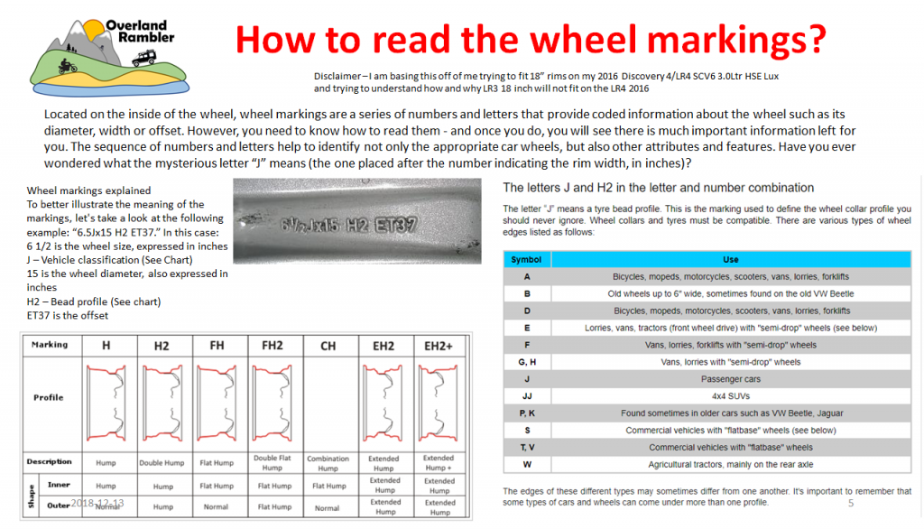

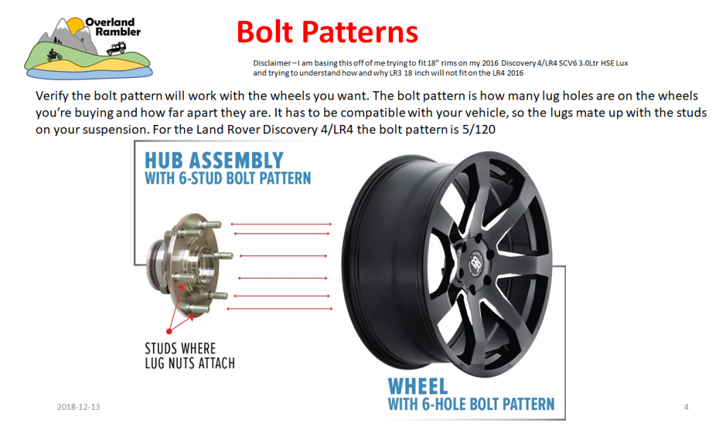

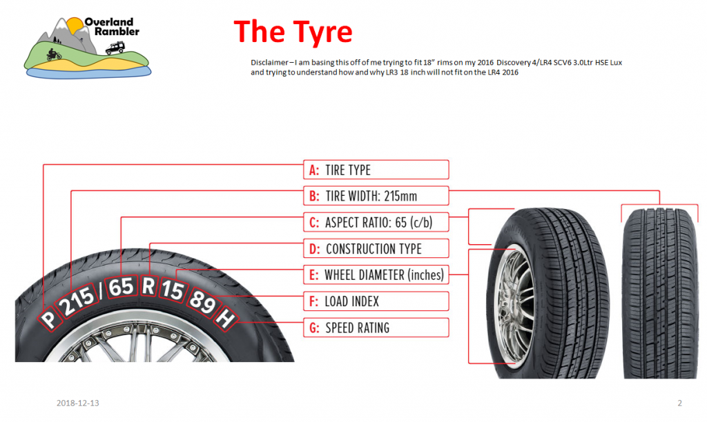

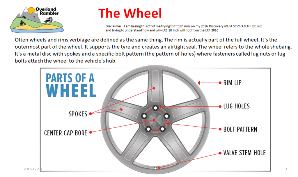

I added a 5th page with this informationI looked at both threads and it's also missing wheel and tire load indexes. Make sure that it can handle the payload. Some steel wheels are available and could fit, but the load index rating are under 1800 lbs per wheel and could collapse under heavy load. So, please account for that as well.
