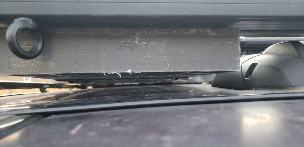

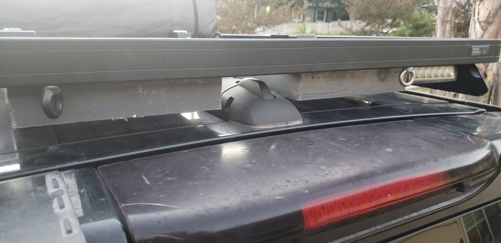

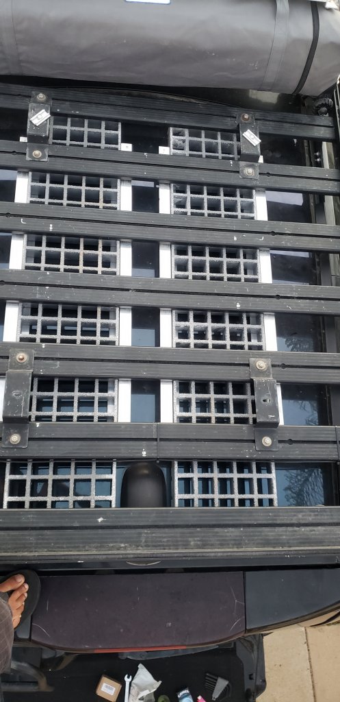

I have the Frontrunner Slimline II roof rack and roof rack real estate is hard to come by with a rtt and solar panel mounted. Recently picked up some waffle (frp bridging) boards and mounting them in a useful/accessible spot was challenging. I think I found the perfect spot, under the roof rack.
I used aluminum z bars, ss hardware, and tapered the fitment where it sandwiches the front end and slightly wider opening in the rear.
View from top.
Glass clearance.
Glass clearance different view.

I'm happy to report the system is solid. I went through several trails in Joshua Tree without any issues, I even forgot it was up there. Went through a few rock crawling sections (< 5 mph), rock gardens (5 - 10 mph), soft sand (10 - 40 mph), and hard packed bumpy fire roads (15 - 50 mph). Everything was smooth, no creeks, noises of any sort. Again, I seriously forgot they were even up there otherwise I would have tested the waffle boards out.
