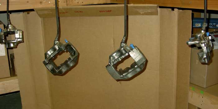

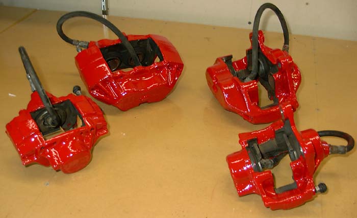

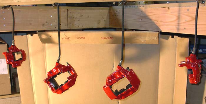

You need paint specifically designed for calipers, it will tolerate the high heat. There are basically 2 options - either spray paint, which is cheaper/easier/quicker but requires a lot of masking to avoid making a mess, OR you can use the more expensive 2-part epoxy paint which is brushed on. The epoxy stuff is better IMO but takes a lot of time, and once the 2 parts are mixed, you only have a few hours to apply before it sets.

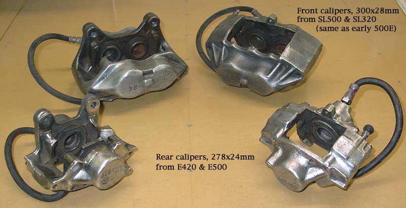

Disclaimer: I did this once, many moons ago, not on a Rover (pics attached). Before anyone wigs out, the hoses were replaced prior to installation, yes I know dangling the calipers from the hoses is bad - I was using the old hoses as hangers. The results were adequate, but given the significant time involved, I don't know if I'd do it again. The "proper" method would be to remove the calipers and send them out to be professionally disassembled and powder coated, but this is $$$$.

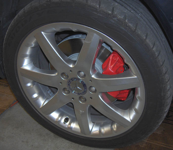

For that particular project, yes, I was happy with the results, and it looked good with the wheels mounted. There were some imperfections in the finish but nobody else would notice except me, and you'd have to pull the wheels to see them anyway. That was my first attempt, I think I'd do a better job next time, but the fact that I never have repeated the job on a different vehicle does say something about the effort required (at least for the 2-part epoxy paint).After it was said and done, were YOU happy with the results? Did YOU feel it looked good, or did it look cheap. At the end of the day, its you who looks at the car day in and day out, not everyone else, so Were you glad you did it?
