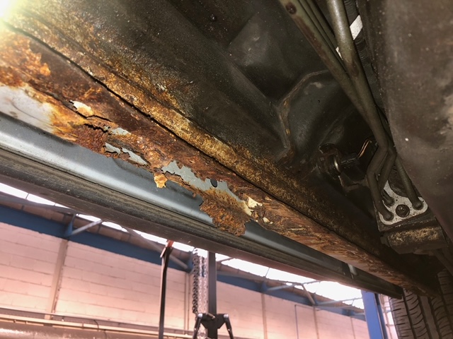

Has anyone seen a worst example of a RRSport 2008 for rot?
The vehicle was an early demonstrator and it’s thought the mud passing down the inner winged at the front, filled the sills up with silt. A massive design fault, as this has direct access to the inner sills.
