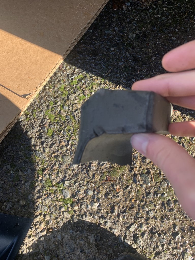

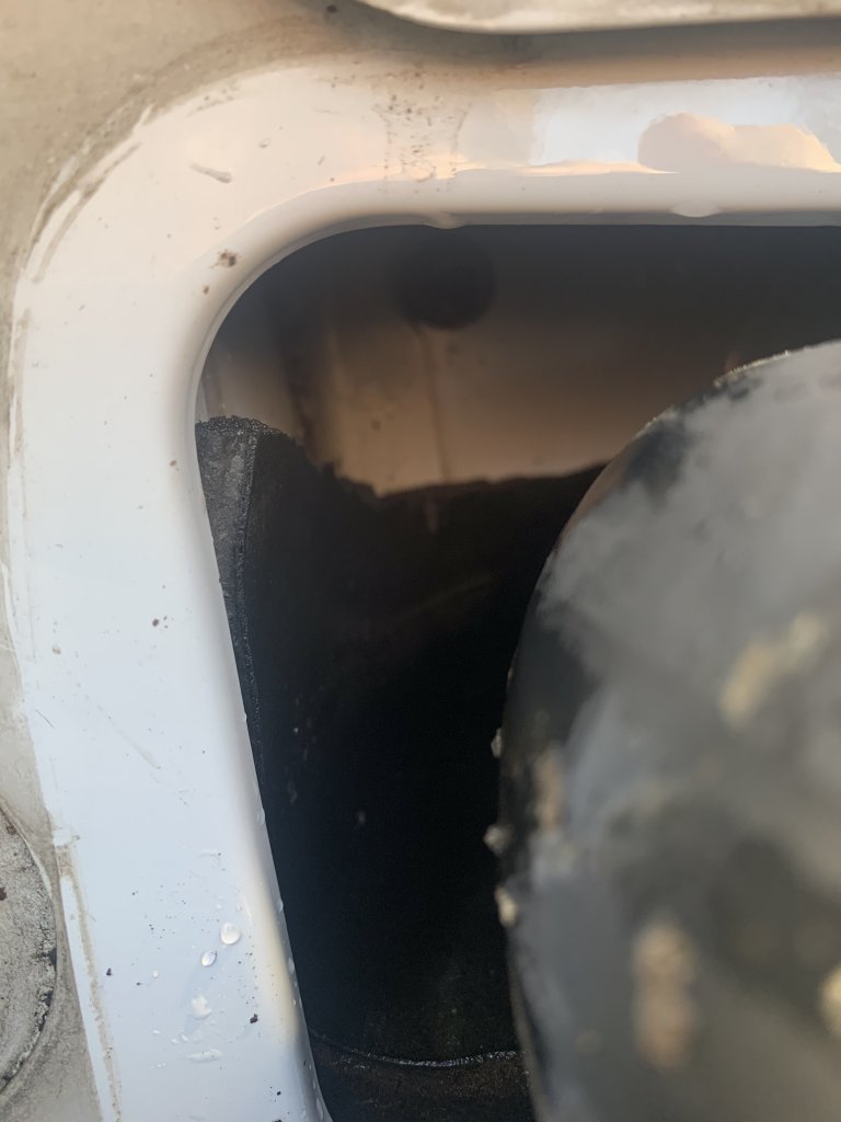

Hey! I know you said water was draining from the sunroof, but I found that on mine the foam sound deadening material behind the fender air intake was actually preventing water from draining fast enough during rainy days. This in turn caused soaked carpets for me. While water would still drain, even at a fairly good rate, it just wasn't fast enough. Solved by tearing the top of the foam off.
