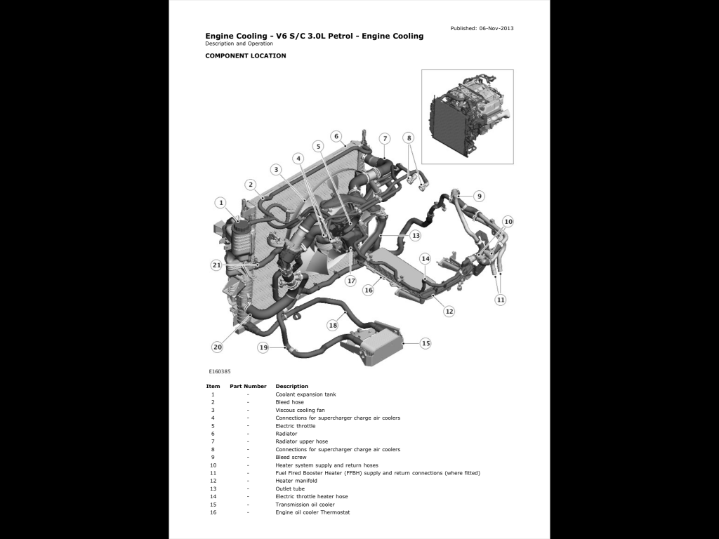

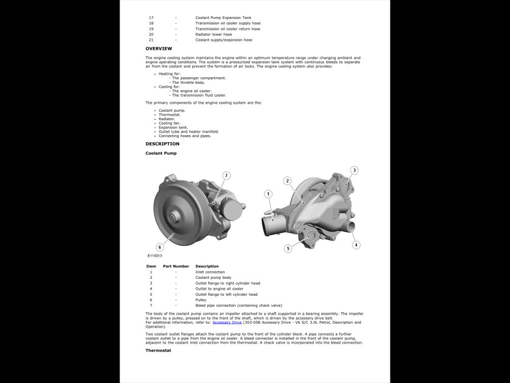

itsaguything
Mar 7, 2023
354
149
Manotick, On, Canada
from the manual. Too bad all the names aren’t supplied.
