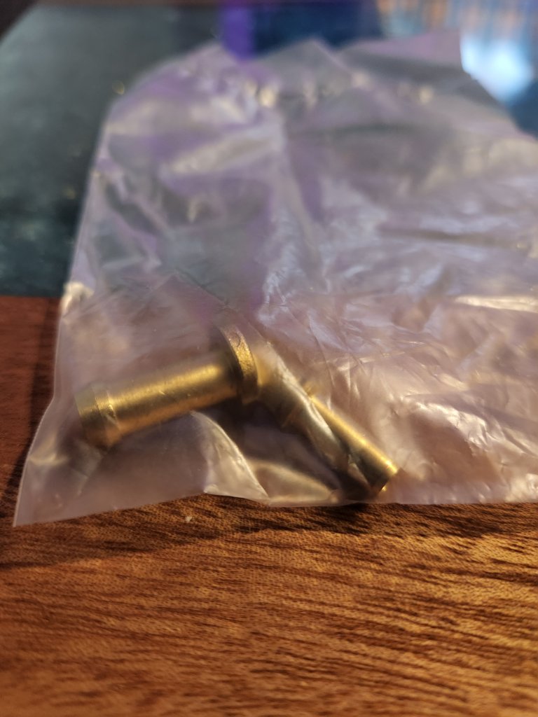

Thanks. Just ordered on to add at some point.
Make sure you get a brass bleeder screw to replace the plastic POS while you are at it.
djkaosone
'11 LR4 HSE LUX 5.0L V8
Oct 26, 2015
772
485
SoCal
Yup, I've been using a bmw brass bleed screw for a few years now. That reminds me, I should preemptively replace the o-ring on it.
