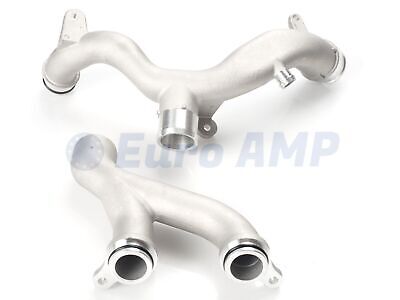

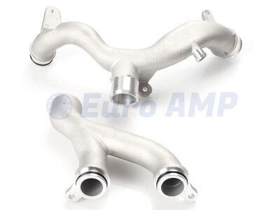

Was bored browsing the jaguar forum (same engine, after all) and came across this recent thread announcing aluminum crossover pipes.
I've never heard of the vendor, but interesting nonetheless... it does claim fitment on the LR4 SCV6
This might be something to look at too.
