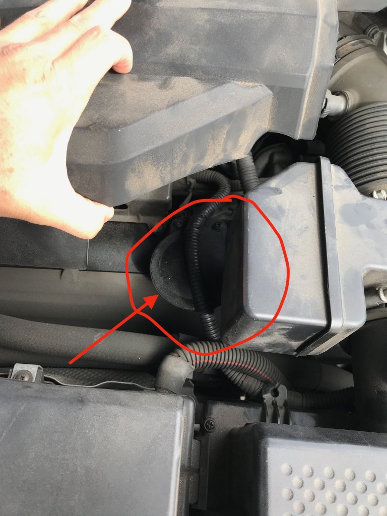

When I hit the gas there is a loud higher pitched whining from the engine. Also noticed my oil was lower than normal and found a leak see picture. Also, if I take the old dip stick out there is a air hissing sound and if I remove the oil cap the engine stalls. 2007 V8 LR3 with 95k miles

When I hit the gas there is a loud higher pitched whining from the engine. Also noticed my oil was lower than normal and found a leak see picture. Also, if I take the old dip stick out there is a air hissing sound and if I remove the oil cap the engine stalls. 2007 V8 LR3 with 95k milesView attachment 9214
Looks like your PCV valve to me. That is what allows gasses built up in your crankcase to vent back into the intake. Inexpensive repair.

Landed in the same place and ordered the PCV valve today. I hope that works.
