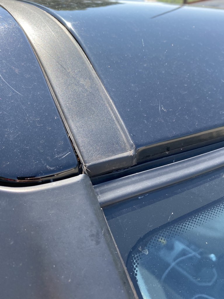

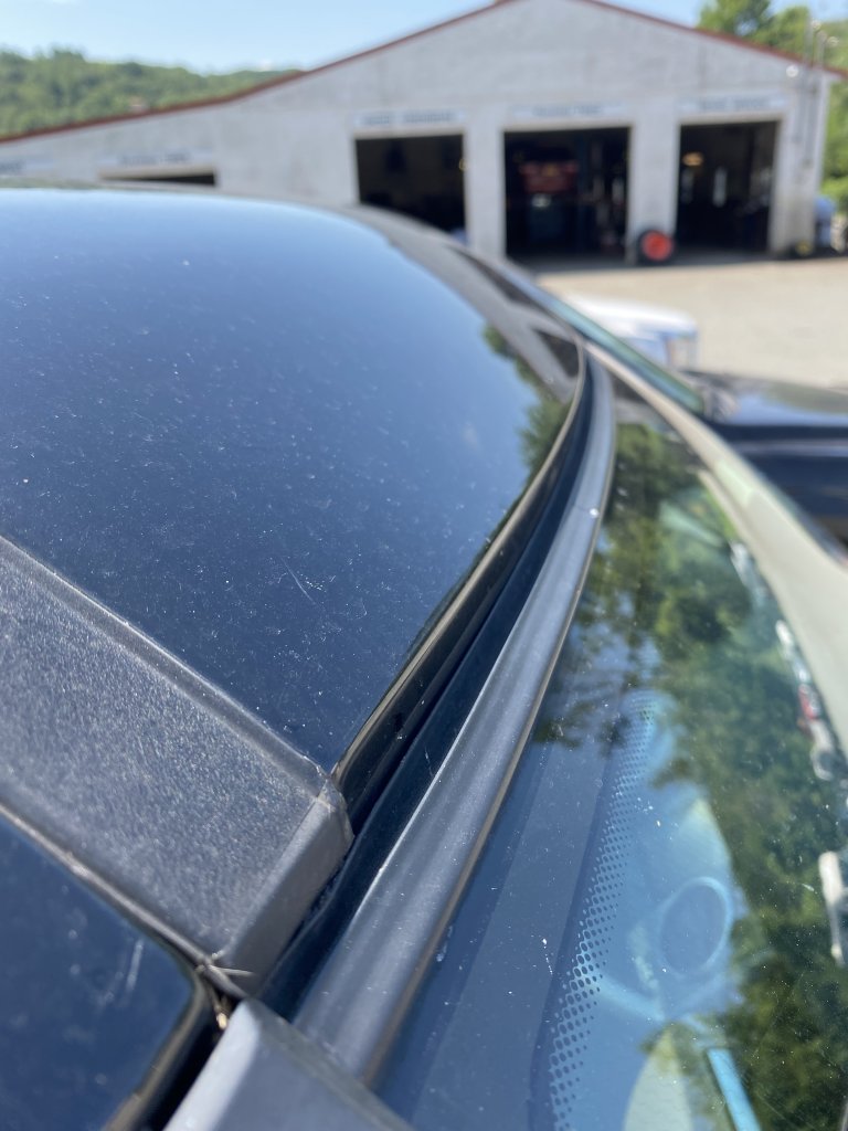

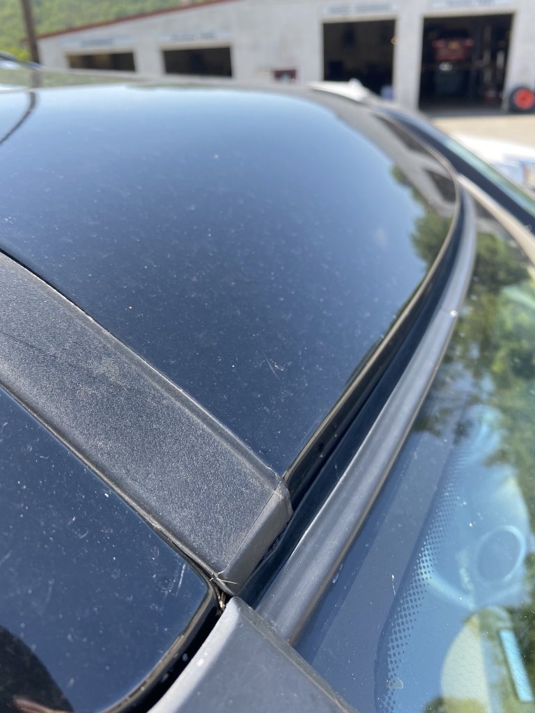

A couple photos of the upper gasket on the windshield as well. Any thoughts appreciated!

Few ideas for hunting this down:
1) Painters tape around your windshield. See if it still persists after that, then you’ll know if it’s the windshield seal.
2) Try opening each door window individually when on the highway. Could be one of those seals.
3) Inspect your door to body seals.
4) Inspect your cowl. Is it warped? Did you perhaps do the anti-leak mod and cover the air intake? Perhaps that cover is causing the hum.
Good luck!

Thanks for the response, and super helpful. Those were all things that I was suspicious of. I did end up painters taping the whole thing bit by bit, and then trying it out on the highway (over the course of a bunch of different highway trips).
To close it out, I was 99% sure it was the windshield seal, especially given that when looking at the VIN, you could tell the whole windshield was low/had fallen during install. I got the windshield replaced and it’s now suuuuper quiet. Only issue is now I can hear more noise from the ridge grapplers I just put on. Thanks again for the help everyone!
