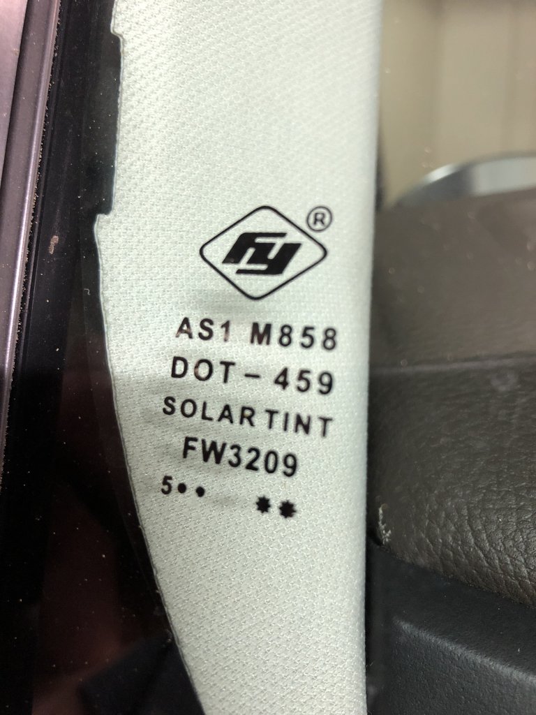

    Mine is a FY see pic.

    It is most likely your windshield.
    I had the exact same problem with the same windshield. You can see in THIS thread that my old FY part number was the same and my rain sensor did NOT work with that windshield. It was a CarMax replacement and it did have the heater wires in it and all.
    I finally got a new OEM Pilkington put in, and the problem when away.
    vlonjati likes this.

    This link decodes the windscreen markings or the lack of them.
    The FY brand is of far east origin per below and it also lacks an E marking.
    http://www.carwindshields.info/windshieldmarkings
    This link below re DOT 459 identifies the manufacturer as being in Honglu Town, China.
    http://www.carwindshields.info/dot_db
    I specify the Pilkington windscreen whenever I replace my LR3 heated windscreen. It is the LR factory supplier and the only difference is the price, (lower), plus the Pilkington trademark is imprinted in the lower left corner of the glass rather than the LR trademark.

    The non OEM referred to above, yes one can see thru it, (that is what the AS1 marking means), but if you need the heated windscreen, then you want the Pilkington.
    There is a reason the Pilkington Opticool costs more - this is not a situation where you get something for nothing.
    The E1 in the Pilkington logo means the windscreen is good enough for vehicles in Germany but note the E1 is missing from the non OEM marking.
    The DOT 682 means the windscreen was made in the Pilkington UK glass factory per below.
