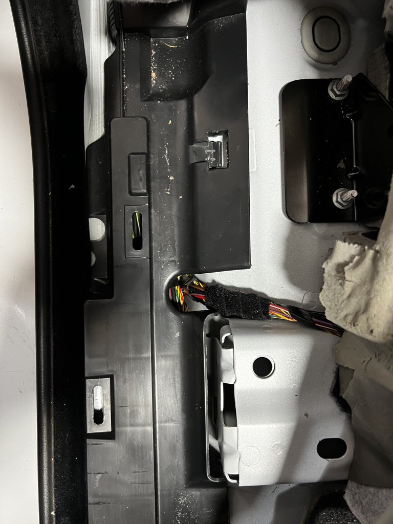

I was wondering if anyone knows how to remove the black plastic wire loom cover that runs along the floorboard on the LR4.

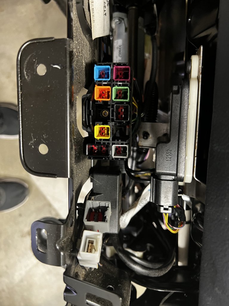

I had this great idea at the time to see if I can retrofit my HSE with heated seats. I figured that all the LR4s had the same wiring looms and just needed the right parts including seats, climate control panel, etc. and activate it using the GAP IId tool.
I’m in the process of doing it now and already swapped out the climate controls and just pulled the passenger seat.
Of course, the wiring loom that I think I need for the heated seat module is not there but wondering if it is tucked away. It’s for the 2 small connectors to the right.

Btw, I was able to pop the black cover off, it wasn’t hard after all, I wasn’t sure if the plastic rivets would pull out and was afraid of breaking them.

Where is the first photo you took, under the passenger seat?

Sorry for not responding sooner, took a trip during thanksgiving and now just getting back to this. The picture is the underside of the passenger seat. I posted it with my iPhone and didn't realize the photos were rotated...
Anyway, the funny part is, couldn't find the plugs for the two small connectors but found the plug for the middle seat. I am going to take another look tomorrow and will let you know what I find out.

I am under the same impression but not sure why it's not there. I did find some wires that were cut and terminated (looks like it was done at the factory) at that location and have a feeling it was for the two plugs. However, not sure why they would have cut those and not the plug for the middle seat.
