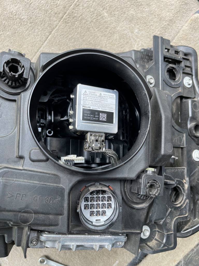

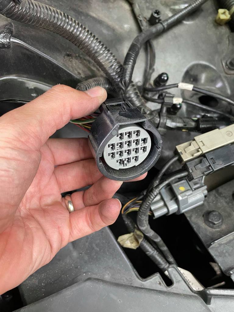

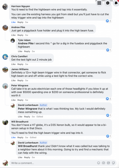

Hey everyone, I have a 2016 LR4 and I was going to wire up my lights myself from Stedi(https://www.stedi.com.au/) but the Stedi adapter that I have (H7) does not fit the headlight configuration that I have. I contacted Stedi but they do not have an adapter for this configuration. I am not opposed to taking the car to a shop to have it wired but before I did that I was wondering if anyone else had run into this or knew what I might try and do myself.

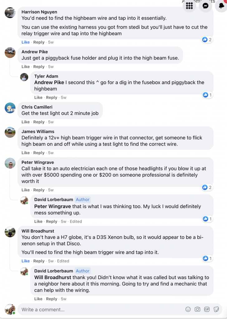

I asked the Stedi Facebook group as well and will screenshot some of their answers but wanted to get a second opinion about wiring.
I know a little to be dangerous so I didn't want to try something on my own and totally mess things up. Just was curious. Hope all is well.
