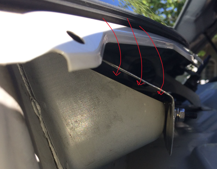

So is the water going down through the area with the arrows as indicated here?

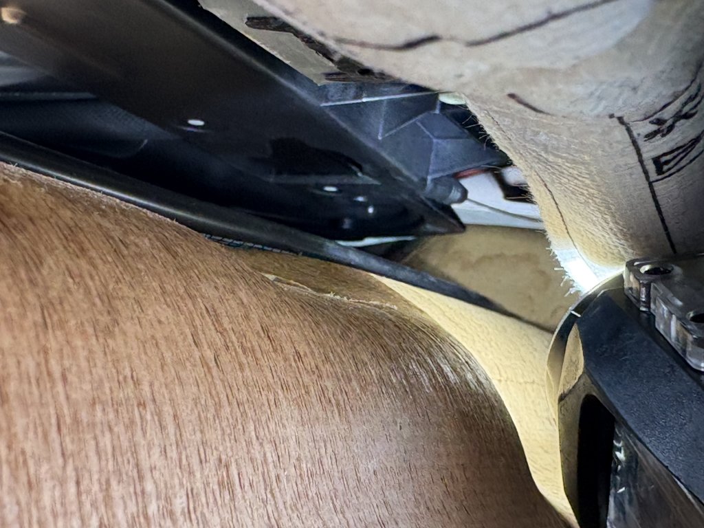

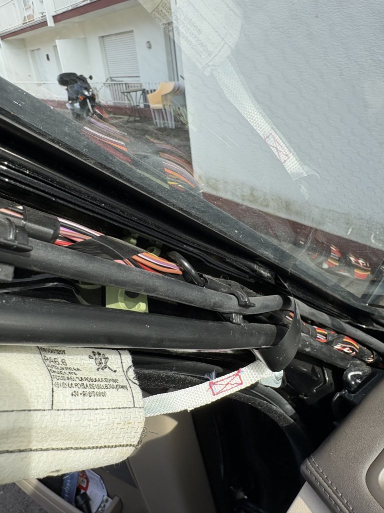

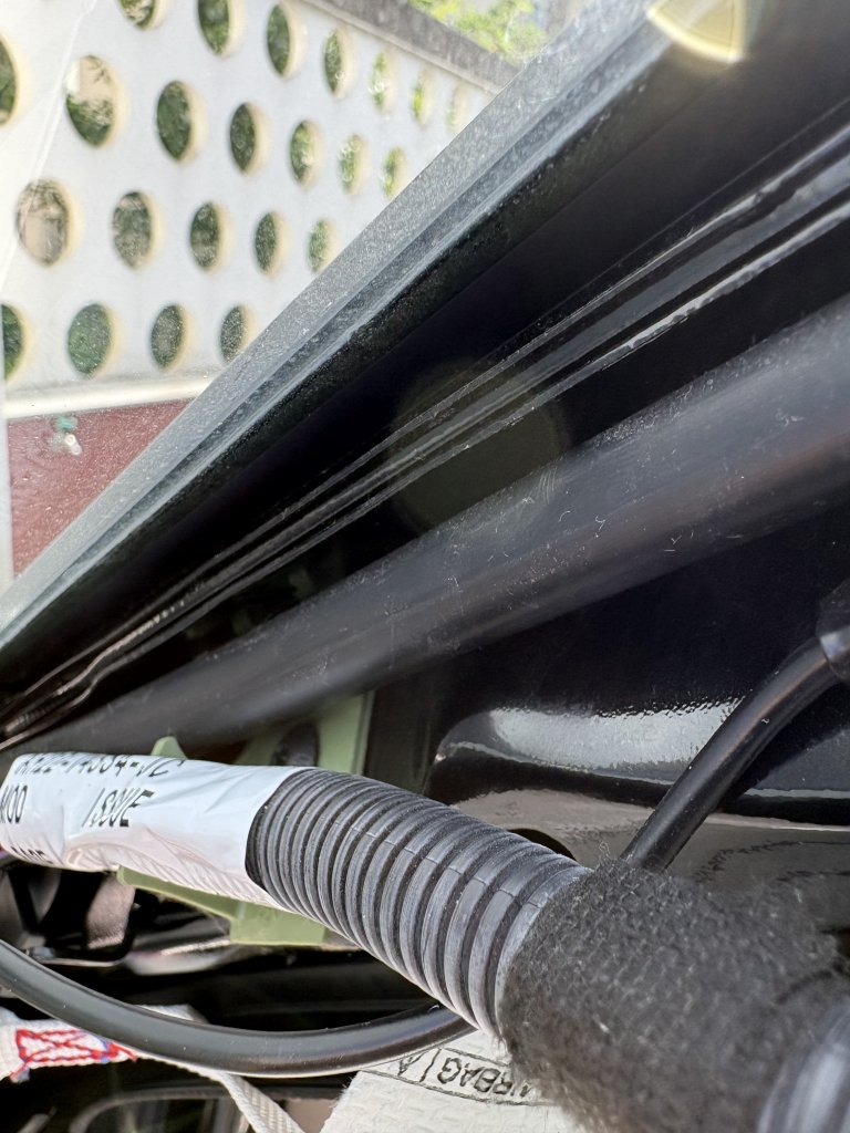

I just did a quick write up about my sunroof drains here: There are a few pictures of the tricky spots that have been discussed here. I also currently have the interior out of my LR4 and can take pics/video and show exactly how/where the drains are run.
