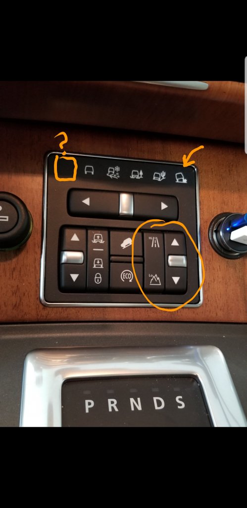

I also recommend Disco (LR3 or LR4) remember to look for HD package (locking rear, rear diff will have a wire running into it).
2014+ you can ditch the legendary timing chain issue of all jaguar V8's in history (you think they would have learned eventually?) and get a supercharged Ford V6 motor in it that has a few specific issues to look for that are minor but a pain to get to.
In 2014+ look for the highway/mountain symbol on the right side of terrain selection module.
