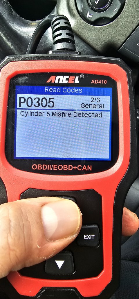

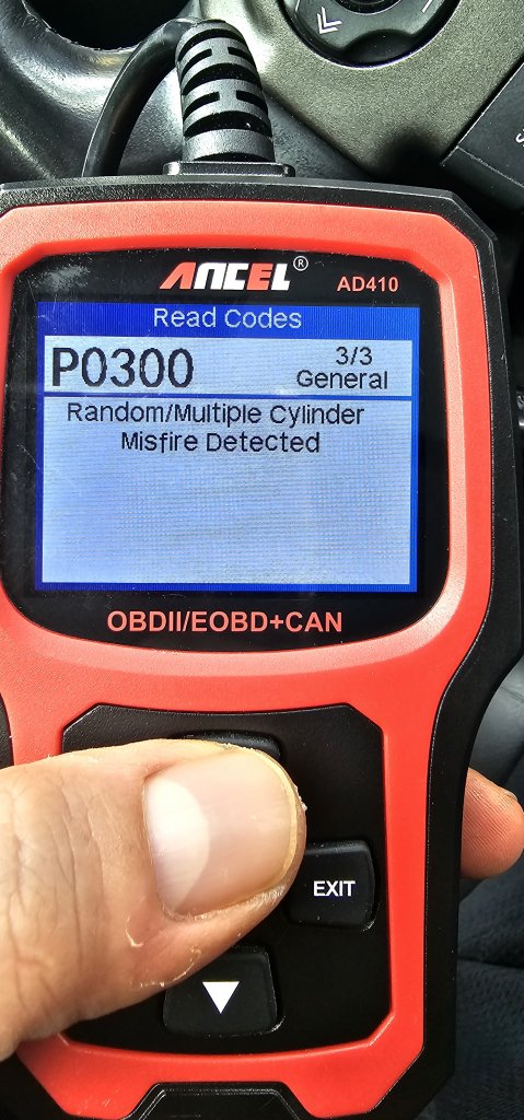

Gotcha, thanks for your input. So I followed some of the suggestions and did a reset and started the car, this time it gave me the Cyl 3, and Cyl 5 as well as multiple/random misfires. the car hesitates even when idle, but not as much though it misses a bunch while driving it. The weird thing as I mentioned is that prior to my work on the LH Valve cover and Injectors the RH Cyl did not misfire! I am going to change the coils and the spark plugs I suppose on Cyl 3, 5 and see what happens. this car is a beast but my god it needs way too much attention! Thanks again guys.
