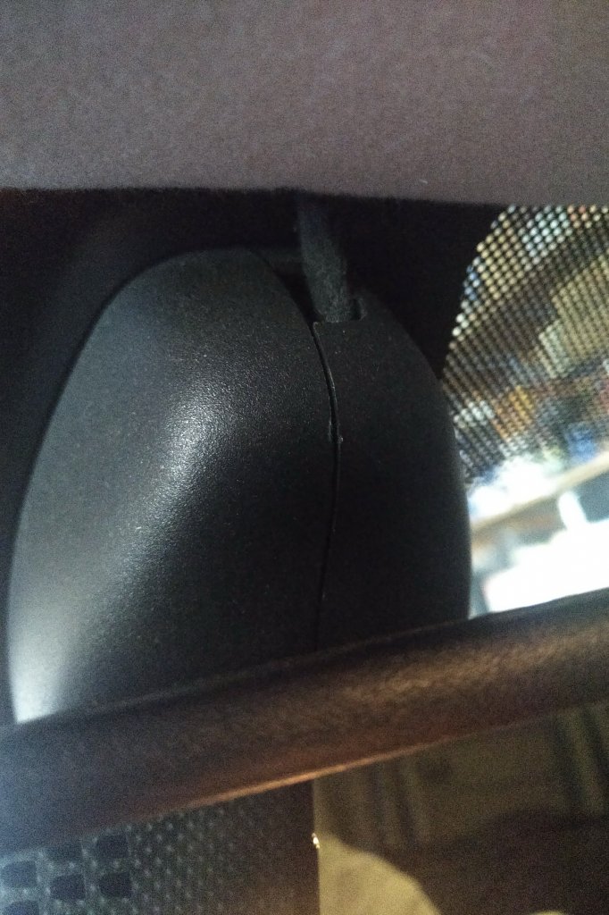

If you still have the original windscreen, the odds are that the glue that secures the optical rain sensor to the inside surface of the glass has let go.
There is a plastic clam shell that unsnaps into two halfs behind the interior rear view mirror that hides the sensor.
I suggest you unsnap it, (kind of just pulls apart), and see if there is something loose that looks like it should be glued to the interior surface of the glass. If so, then as an experiment, tape it to the glass and see if anything changes for the better.
If so, then go to a glass shop and get them to use optically correct glue to reattach the sensor.

Thanks for the reply, how exactly do you unsnap it? I can’t seem to get it out

Use something, maybe a flat blade screwdriver or nail file to pry the plastic halves apart. If your cover is per the jpg, just start at the top where the wires go in.
In my case, they almost fell apart when I started; in fact I wondered why they had not seperated going over a bump etc.
