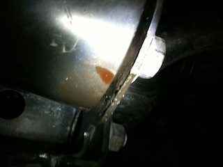

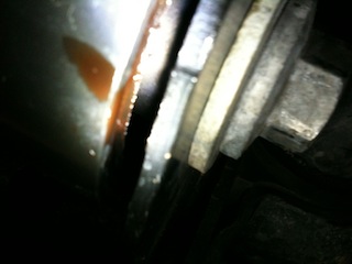

Hi all,
I just saw some drops of blackish fluid on my garage floor today and its coming from the lower control arm front bushing-passenger side.
Is this passable oil in the bushing. HELP:confused:
dragan
Apr 1, 2009
102
yeah, I was wondering if it could just be some tar picked up from the
road .

kingfishgrapeja
Aug 10, 2009
239
looks too light to be CV grease. Looks like motor oil if anything. Does it come back if you wipe it off?

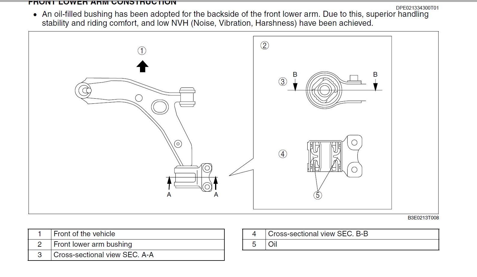

answer to bushing problem

Houm_WA
Jan 6, 2006
3,948
261
How is that an answer to the problem? It was already known that the rear-most bushing on the lower front control arms are hydro-bushes. The question is whether or not that is indeed the source of the leak....
LRB
May 13, 2010
45
Yes They Are Oil Filled. My 05 Lr3 Is At Lr Right Now Getting The Control Arm Replaced Because Of This On Driver Side. Same Thing 6 Months Ago With Passenger Side. It Is Leaking Oil From The Oil Filled Bushing. Thank God For My Ford Esp.
