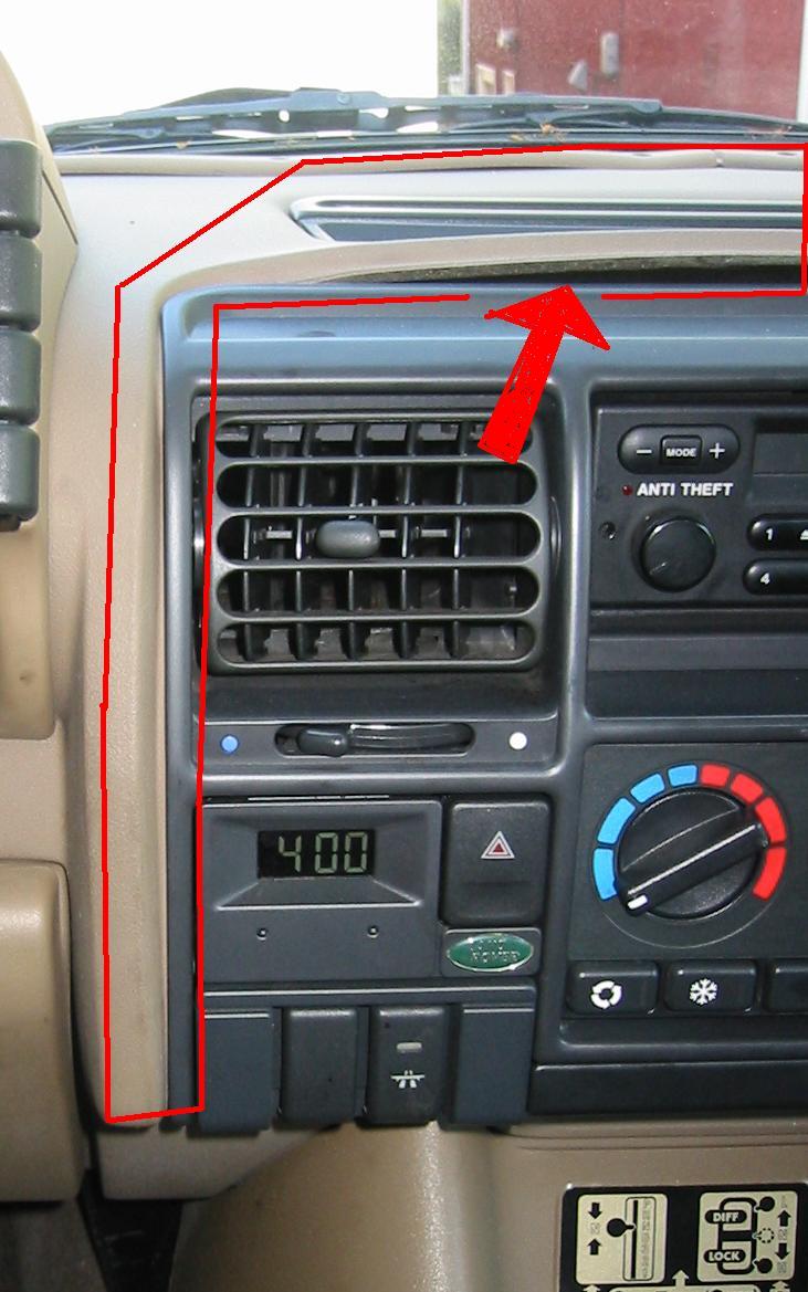

My Dashboard in coming apart at the top of the center console, is there an easy repair? or even a difficult one? other than replacing the whole dash?
have a look at my problem, it is also occuring a little on the right and left sides:

I don't believe that you can glue the dash other than replacing it. 95' Discovery's are known to have lifting dash problems which, LR replaced even after the vehicles were out of the warranty period. I had mine replaced (free of charge), a year or so after the warranty expired. You could try and hit up LR but after all this time I think it would be a long shot.

MY 94 has the same problem. identical to your pic... I was thinking of removing the centre dash console and glueing it down. I'll let you know how it turns out.

The front edge you can get a kit to screw it down.
For the edge in the pic I glued it down.
2 ways get some Rhino Glue from Home depot or Like this glue is very strong and expands to fill in gaps. Remove console the black trim round the heater vents radio etc apply glue and clamp. opr stick the glue in the gap and squeeze with 2x10 fro the back seat to the dash put some brick on the 2x10 to push the dash down.
As for the front edge you can only glue down when the windsheild is out. So wait till you need a new one or by the kit.

Ok here's the update. The local supplier of the kit wants..........Wait for it.......$400, yeah right! For this sort of money I can get a second hand dash from the various LR wreckers. Undaunted, I did a search. Here's a result that looks like it will do the job of fixing any "lifting" at the windscreen, however, you may need to try Discosid's suggestion for your lifting problem at the front vents.
