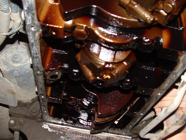

It can be done on ramps. Yep, you'll have to remove the stabilizer and sway bar. Just unbolt the sway bar bolts at the end of the bars and it should just swing down. Of course, drain the oil first. This would be a good time to run a can of engine flush prior to draining the oil and dropping the pan. Once the oil is out simply unbolt the pan and let it drop. Once the pan is off you will see the pickup tube pointing down at you. At the end of the tube is a screen that will need to be cleaned out. I bought a new pickup/gasket along with a new pan gasket. When you put the pickup back on, it would be a good idea to use a lock washer and a dap of loctite to the bolts to prevent them from backing out. Make sure everything is spotless make sure you can eat out of the pan. Install new gasket on pan and put pan back on. Its a real simple job. Here is a pic of what it will look like with the pan and pick up off. The pick up bolts to the passenger side of the block (right side in pic).

Posts: 827
yep.. thats the nasty underneath.. altough mine did look much cleaner after all the crap i poured in it.. :) Nice to know it actually making difference
