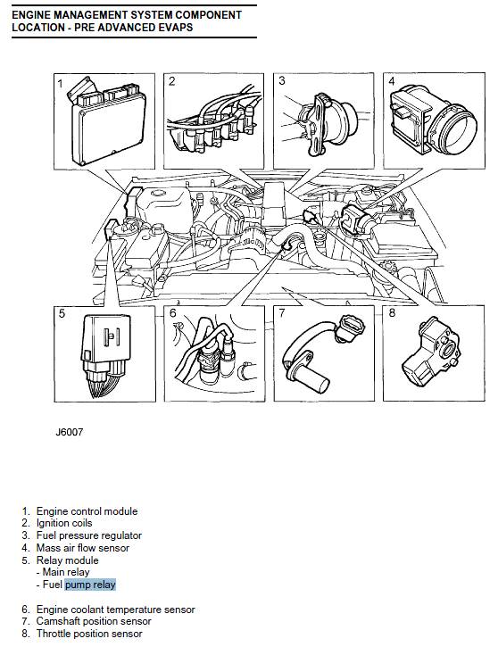

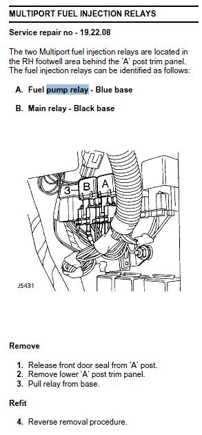

Im trying to locate the fuel pump relay on my 1998 disco. It is supposed to be on the RH side behind the kick panel but I have no diagram to know which relay it is. Anyone have a diagram
Thanks
