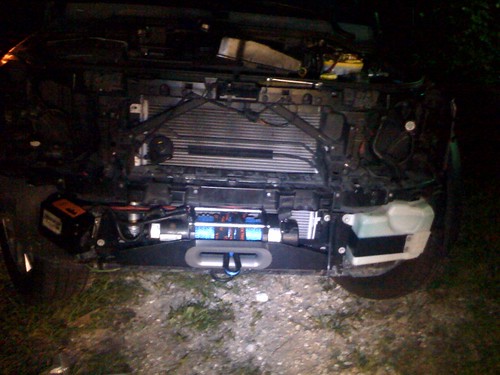

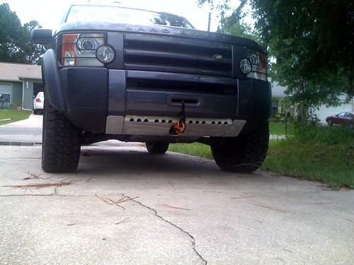

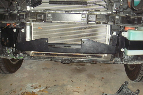

I've got an internal mount and love it. It's not a rasta one its made by a guy in england RLD aka Uncle Ray he's over on the disco3 forum. It's fairly straight forward to install, the biggest headache was cutting the hole in the bumper for the fairlead. I think that mainly because of the fairlead I went with if you go with others it would be easier but IMHO it was worth the extra work.
In regards to being harder to respool I went with synthetic line so respooling is quite a bit easier and not as critical as it is with steel line.
Heres a few photos of the instal and results.
