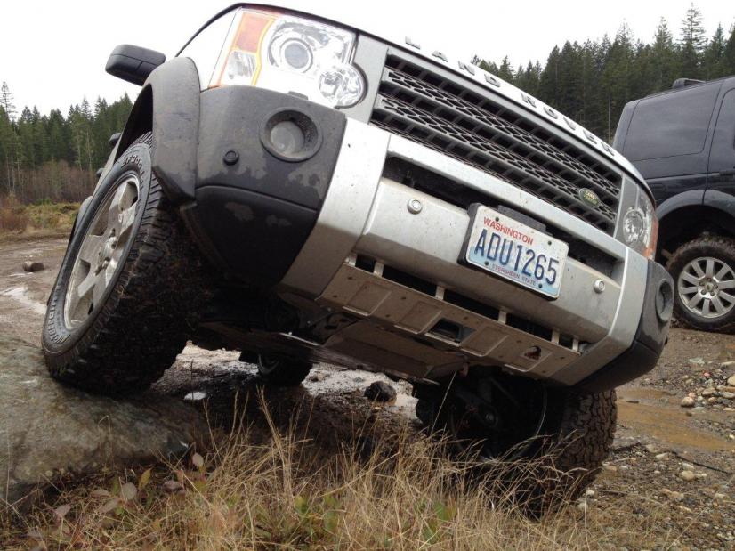

Stuffed...um no. See the pic below. My passenger side wheel should be stuffed atleast 2 more inches.
The goal of the disconnect is not droop on IFS. Lets walk through an example. OK we are going over a rock on the passenger side front. As you start to go up the rock, the wheel compresses. As it compresses the sway bar starts twisting. As it twists it starts lifting the other side. So instead of allowing the passenger side to compress fully to bump stops before "lifting" the truck, the sway bar starts the lifting much much earlier.
clif notes: sway bar causes the vehicle to lift before the wheel is compressed fully.
And here is the best example photos I can find, look at the increased ability to stuff the front wheel, maybe 2 more inches on the blaser.

So you are saying that the unsprung weight of the other-side wheel and tire would keep the compressed-side from getting further stuffed? I'm not sure I can mentally accept that.
Also...I meant the rock that Ryan, myself and Nasir climbed up last month in order to demonstrate the control-arm hitting the air shock...not your Tahuya example.
