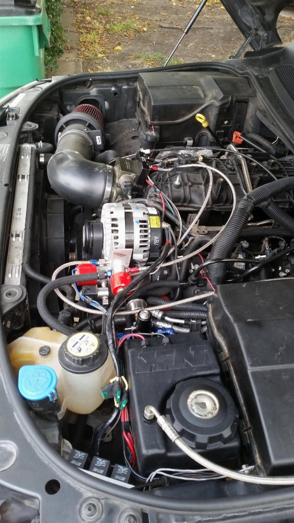

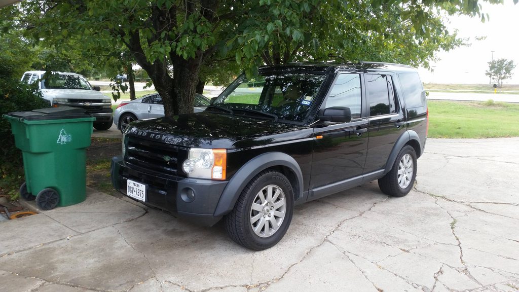

Pictures:
The car drives like a normal LR3 when on all motor (maybe even a little faster than OEM).
If you guys have any questions, feel free to ask. I hope this will be inspiration to spawn more swaps in this community.

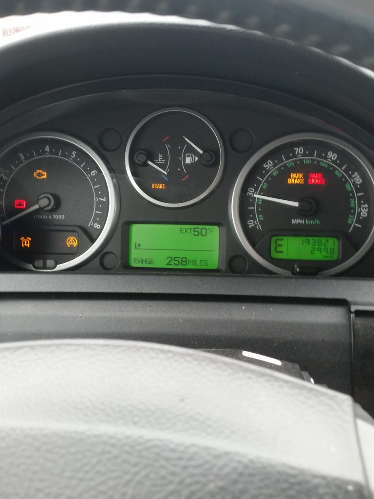

-Does everything on the dash still work? How do you operate the transfer case? I assume no more functioning terrain response?

I think the cold air intake should be routed into the fender like factory. Those cone things aren't actually "better" as they pull hotter air from the engine bay. You're not going to be running it like a race car so it just doesn't help any.

- Right now I have the OEM gauge cluster in it.
As to be expected, I have almost all error lights imaginable lit up. I bought the 4Dcan tool (Land Rover LR3 - 4Dcan Diagnostics) in an attempt to disable the lights. That didn't work. So now we've ordered VDO's new CB500 cluster which should fit the dimensions.
The OEM cluster has very few features which still work. The speedometer works and the digital information panel works which is nice because it displays fuel range. Fuel economy has increased with the swap. I now get 400-450 miles per tank.
You totally should give it a try! We need more swaps to start popping up.
We had the same idea about the CAI so we wound up modifying the OEM airbox. Fitment worked so we were happy. Until we drove the car around... Performance was bogged down and airflow was restricted. So basically the car performed better when sucking in a lot of hotter air than just a little bit of cooler air. With that realization we put the CAI back on. Right now we're working on adding a heat shield or sealing off with plexiglass. Stay tuned for that.
