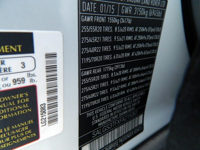

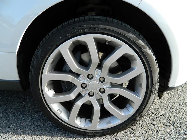

Well, it really is dependent on sidewall height. For example, the stock 275/40/22 on a RR is on 9.5" wheel where the spec is 9"-11" (10" being ideal). This is akin to the 275/55/19 tire on an LR4 in that both are one size off "ideal" wheel width and one size up from the lowest allowed wheel width. The 22" tire below would have more "bulge" than the same tire on a 10" wheel, but hardly a concern (in my opinion), it certainly does not look bulgy in the photo. In theory as the sidewall height increases the aesthetic of the bulge may become more pronounced and there "technically" could be handling implications, but usually within manufacturer specs (of which they ALL use the same range of wheel sizes) there is not a significant difference.
Even the base model size of 255/55/20 is on an 8.5 wheel, where the spec for that size tire is 7"-9", so in this case the tire will run a touch more narrow than the "ideal" 8" wide wheel.
I can't argue the semantics of those differences because that would depend on the specific tire itself and how it is driven. But overall I would not be afraid of a 275/55/19 tire, the sidewall is still relatively small compared to a 33" tire on a 16" wheel.
