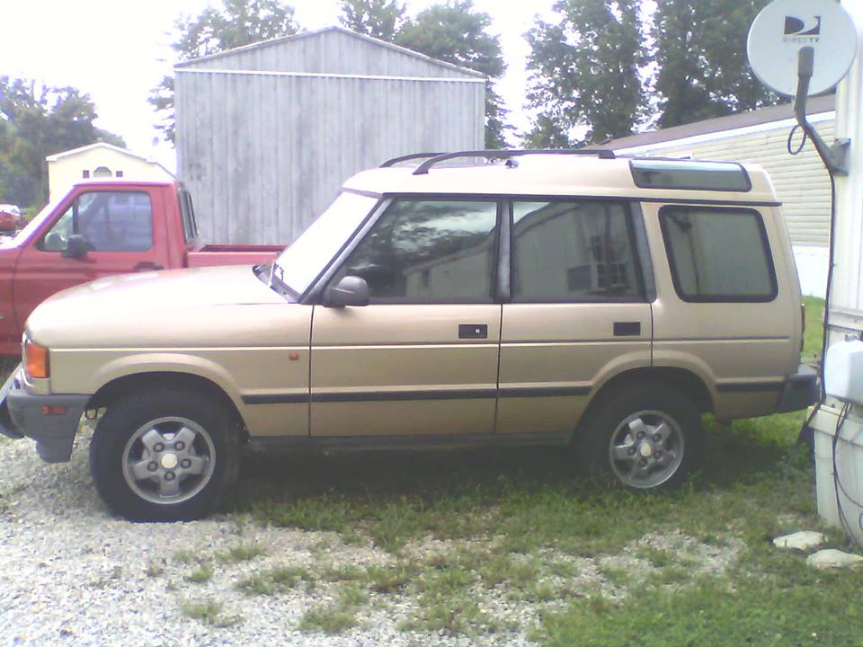

10646949_693900894032248_8545960654707186784_n.jpgthis my 300 bucks land rover
