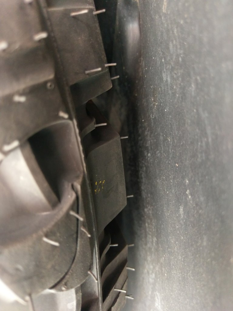

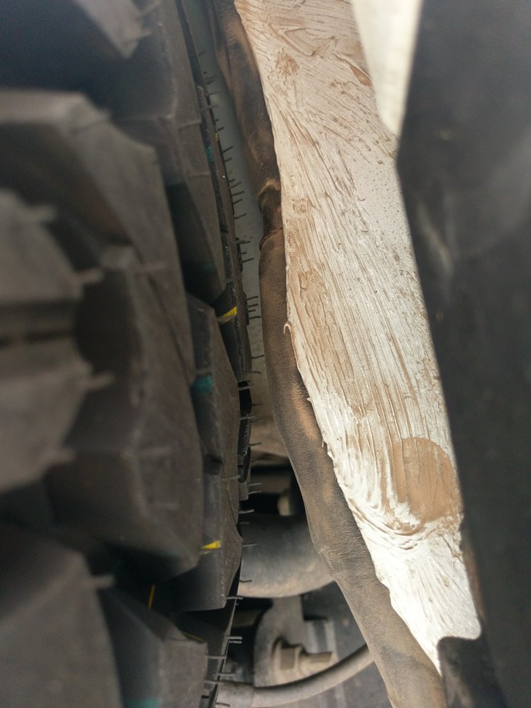

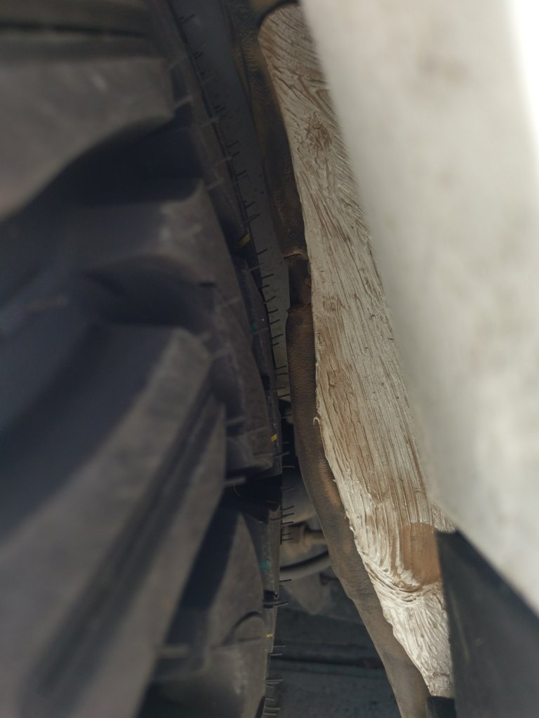

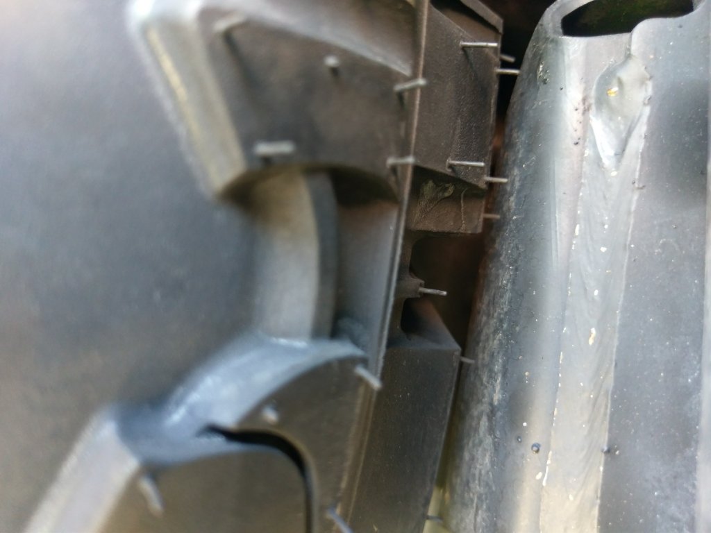

I must say, I was so tempted by the 275/55 but erred on the cautious side. After seeing the clearances I have shown in my photos at very top of post (dropped to the bump stops), there was not much to play with as far as clearances go. Comparing the size 285/50 =793mm and the 275/55=810mm there is a 17mm increase in diameter so halve that and she would be touching. Remember, the photos below are on the bump stops.
Front liner
Now, I know alot of you are running permanent lifts and would say "my car would be clear with 2 inches of lift", but at the end of the day, through full articulation of the wheels when offroading, you will potentially rub when the wheel travels through these areas. So if it touches at the bump stops, you will touch when offroad.
I noticed that this morning when I dropped my truck into access with worn tires. Very close at 275/55.

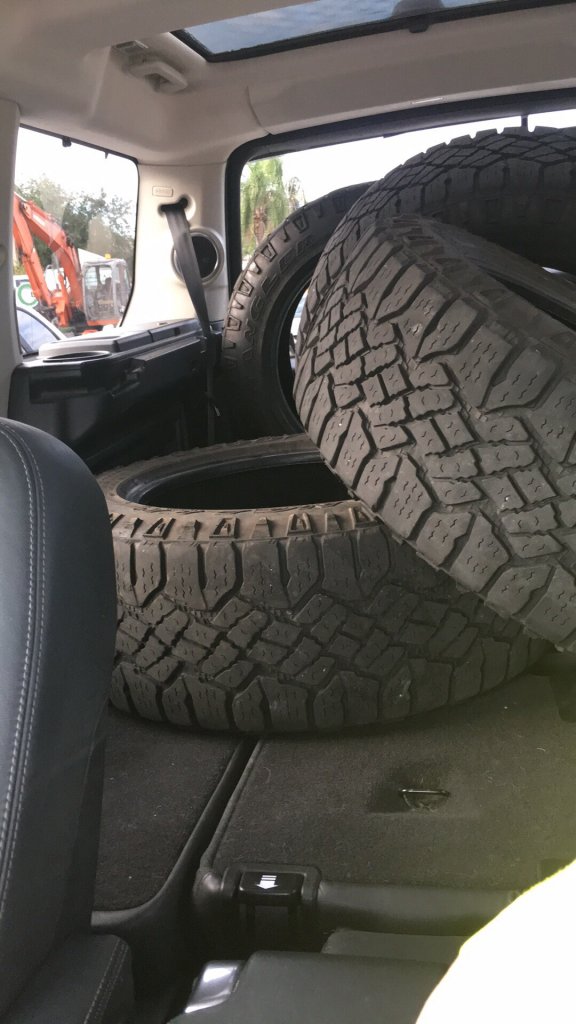

Tire update. Had 275/55 KO2’s mounted today. 20mi on them. So far they ride great. No more shaking steering wheel or heavy planting.
Selling old set for cheap. Tire shop said 40% tread remaining. This isn’t the thread for selling, but if anyone’s looking for a cheap spare set let me know. 275/55r20 Duratracs.
Pics, dude. Pics.
