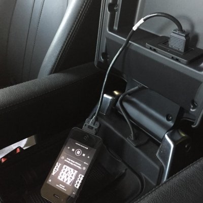

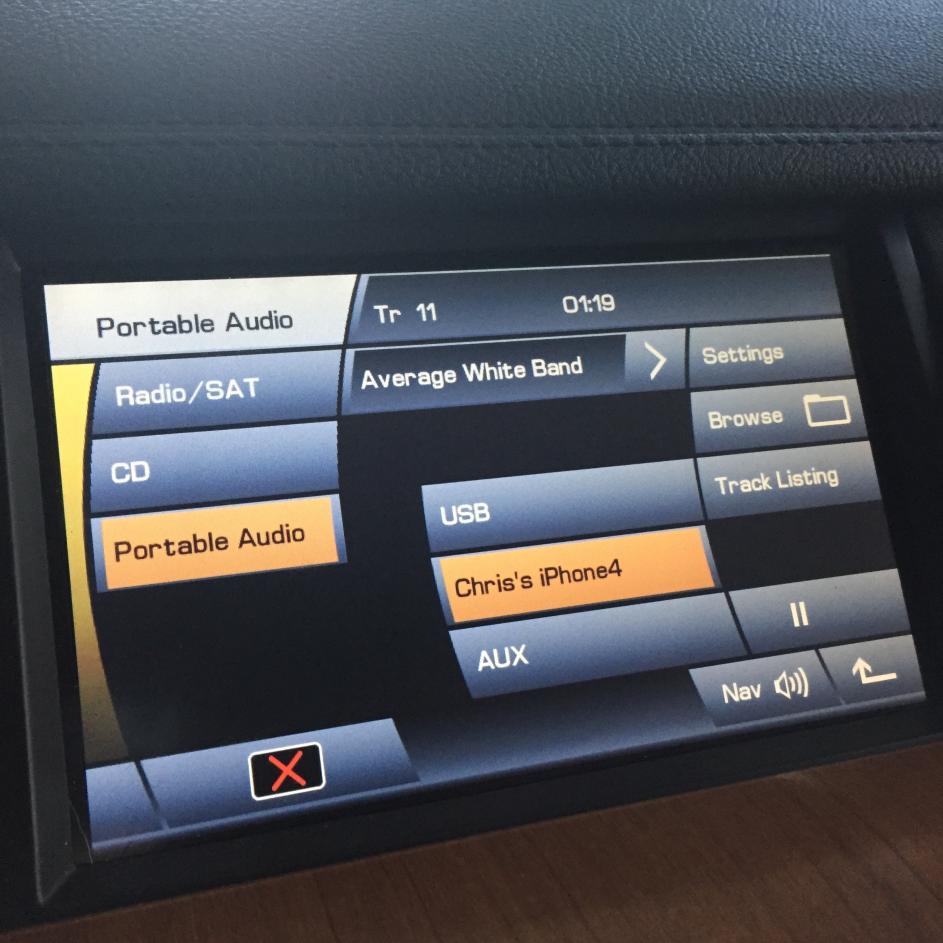

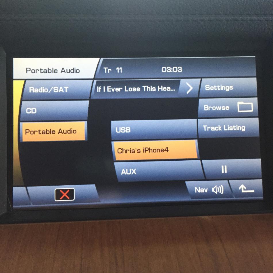

pearsth, it works, but it is extremely rudimentary and not a satisfying user experience in the least. Yes, Spotify will play through the 30-pin connection using the "iPod" source button. You can adjust volume up/down via the steering wheel controls. You can also advance and go back between tracks, or hold those respective buttons to shuttle forward or rewind a given track. Song info shows up on the display in 3 modes: song title, band name, band name+genre. I tried the "Track Listing" button to see if it would display the Spotify playlist but I gave up after waiting a few minutes.
I have attached a few shots of the display. IMO it is not a workable solution because navigating Spotify/Pandora would require you to still handle the Touch and fumble with it while it is tethered to that short, stiff cable with your console lid flipped up. OTOH, if you have your playlists all teed up and simply let it play, it could work.
PS: I have been a longtime advocate of the Kinivo BTC450 Bluetooth device. It does connect through the rear of the console but uses a smallish L-shaped plug into the AUX port and the power adapter has a pass-through USB slot that can be used by passengers in the rear. Honestly it is rare that I have passengers in my LR4 but I have never had an issue with the cables getting snagged or yanked out. For about $30 it may help you even if it's only a stopgap solution. I use this interface exclusively now for both music/podcast/audio streaming as well as phone calls. My .02!
