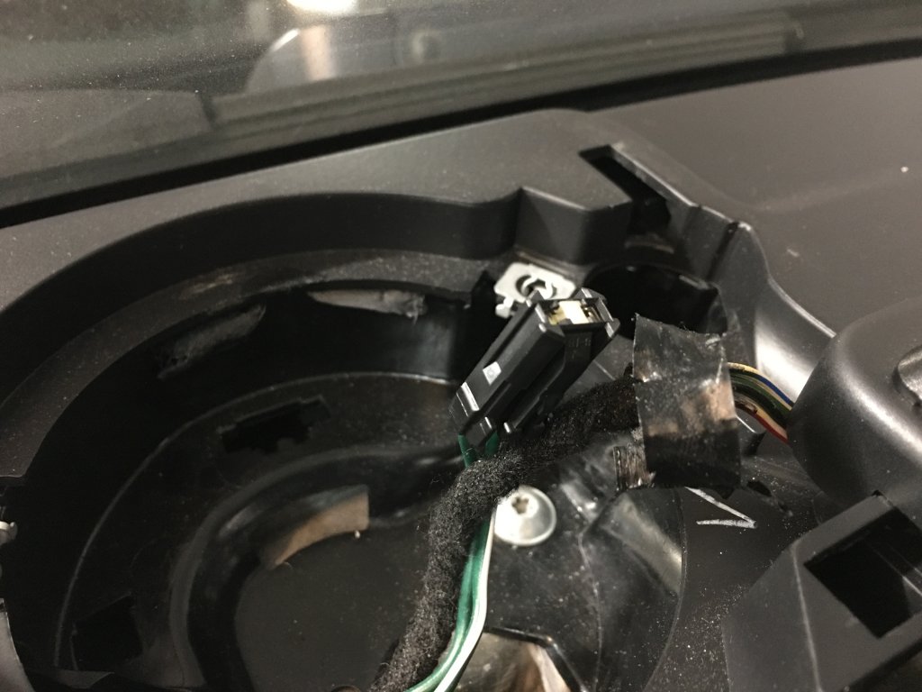

Opened the center speaker on the dashboard. Bc I have a HSE, there was no speaker. But to my surprise, there is a speaker connector. Has anyone attached a 2.5in speaker here? Do you need the upgraded amp or will it pipe stereo through as is?

honestly if you wanted to install them in the OEM places I’d swap the amp for the 825w Logic7 Harman/kardon System or if you want to go a cheaper route the 480w Logic7 that was offered with the 10-11 LR4. I have the 480w System in my car. Great system apart from the bass in the 2nd row. I plan on dropping about 1k into putting a 500w sub with an amp and just linking it to the OEM one in the tailgate. Also I believe the base harman/kardon system uses different speakers then the Logic7 speakers because of the power output difference. The Logic7 speakers should be a bit stiffer so if you do plan on swapping the system then consider doing that too. But what are you specifically looking from by upgrading your system.

To be completely honest with you I’m not completely sure. Honestly before you go through with any of this I’d make sure to put a speaker into the front center speaker and see if that works because I’m very surprised that they went through the effort to wire it there with the system you have. But I doubt that they did wire the rear with points to plug in speakers considering it’s claimed to be an 11 speaker system. Nun the less i could be wrong since you already found a wire to the front one making it a 12 speaker system. Before anything else tho make sure that the plug in is actually connected to the am by putting a speaker there and seeing if it works.

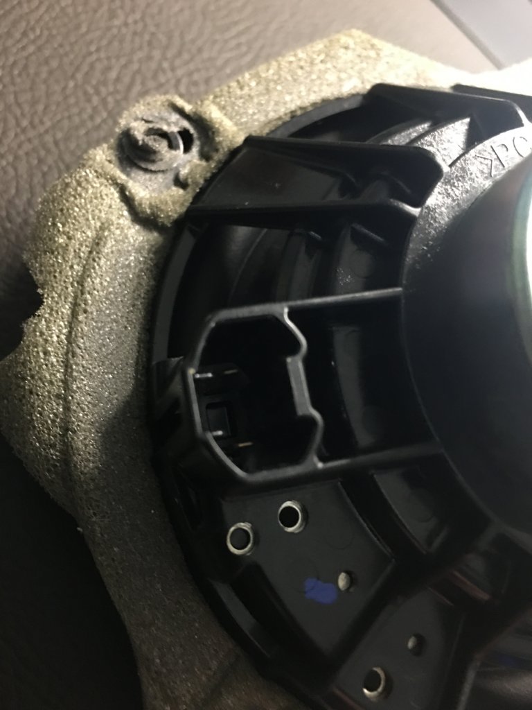

Update: I connected a friend's LR4 center speaker to my HSE center. They fit, which was nice. But there is NO power to the speaker.
Here is the connector to the base for reference. I'd like to find a speaker harness at some point. Need to get power to the speaker in the meantime.

Yes and In order to get power I’m afraid you might have to get a new amp and get the wiring all done. Like I said I’d suggest getting the 825w Logic7 if you can find it.
